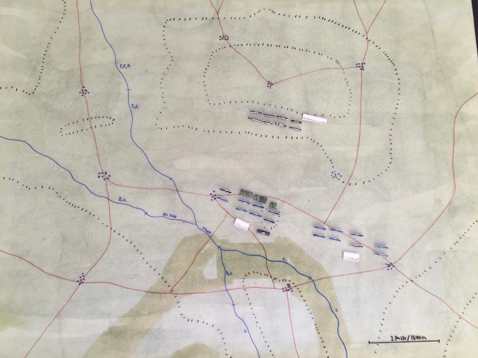

forwardmarchstudios28 Aug 2017 9:38 a.m. PST
Here's a better version.
The hash-mark hills are put on with permanent marker on the plexiglas. Its quite fast, and is less confusing. I've also annotated what troop types can ford rivers at what points. Lots of information on this map, and I believe it could fit a lot more. Also, some random corps formations set up.
