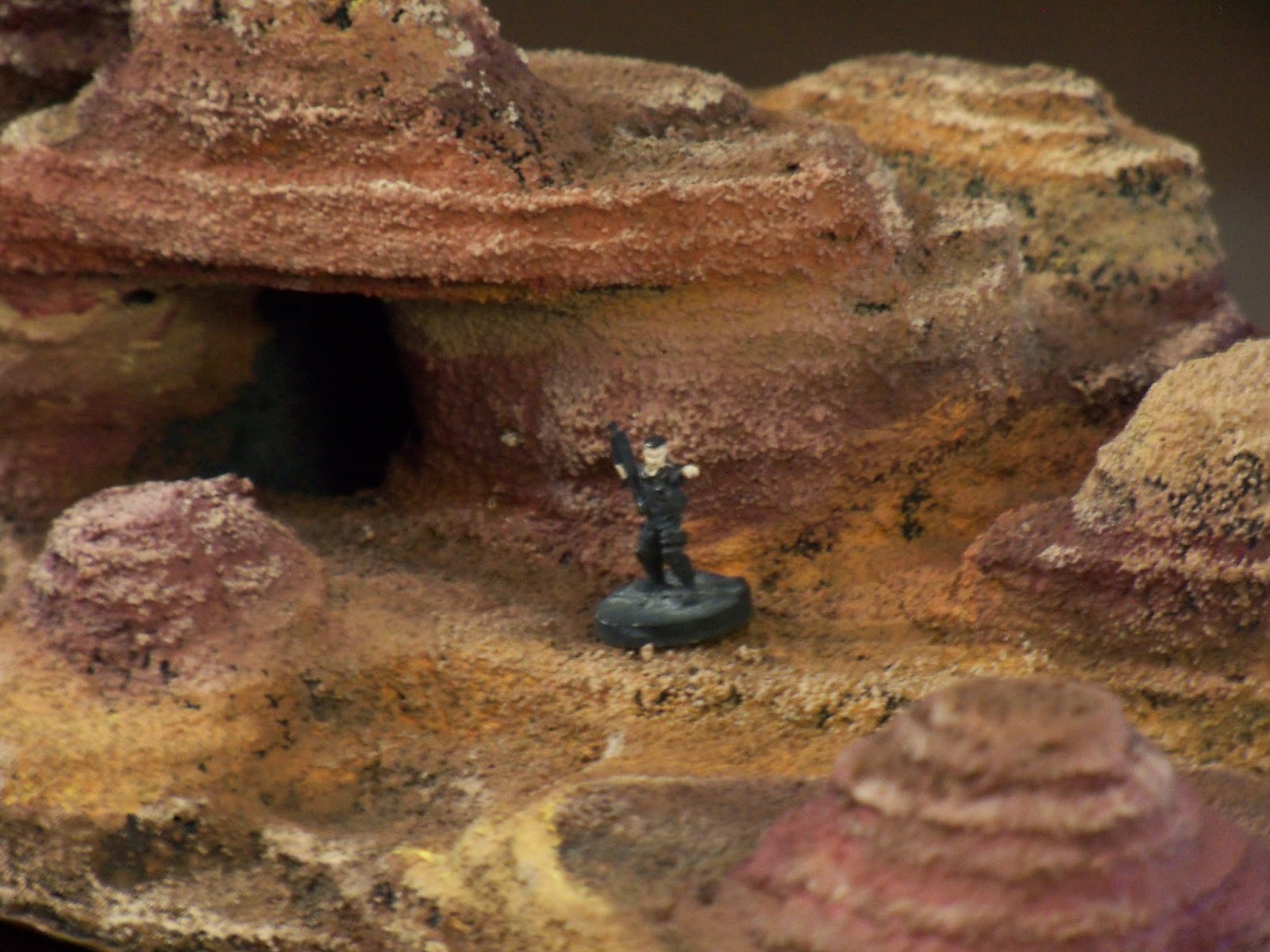

War Monkey04 Aug 2017 3:33 p.m. PST
Okay you could make this for any scale size but worked on this for my 15mm Gaming
I'm working on many more, basically working on it like a layer cake.
Covered in tissue glue sand and paint
More pictures here link
Thanks for looking
Doug
silo1313.blogspot.com

By the way, I finished gluing and covering with sand "The Cave" aka "The Red Frosted Layer Cake" piece and as soon as it dries I can paint it.

War Monkey03 Sep 2017 1:36 p.m. PST
Just an update "The Cave" piece is finished.
Sorry about the photo focus I just couldn't keep my hands steady.
here's a better photo.
More about this project here link
Doug
