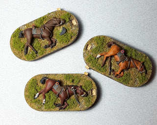

Jabba Miles11 Aug 2017 4:14 a.m. PST
Just finished mine, Front Rank horses and Charlie Foxtrot Models bases.
