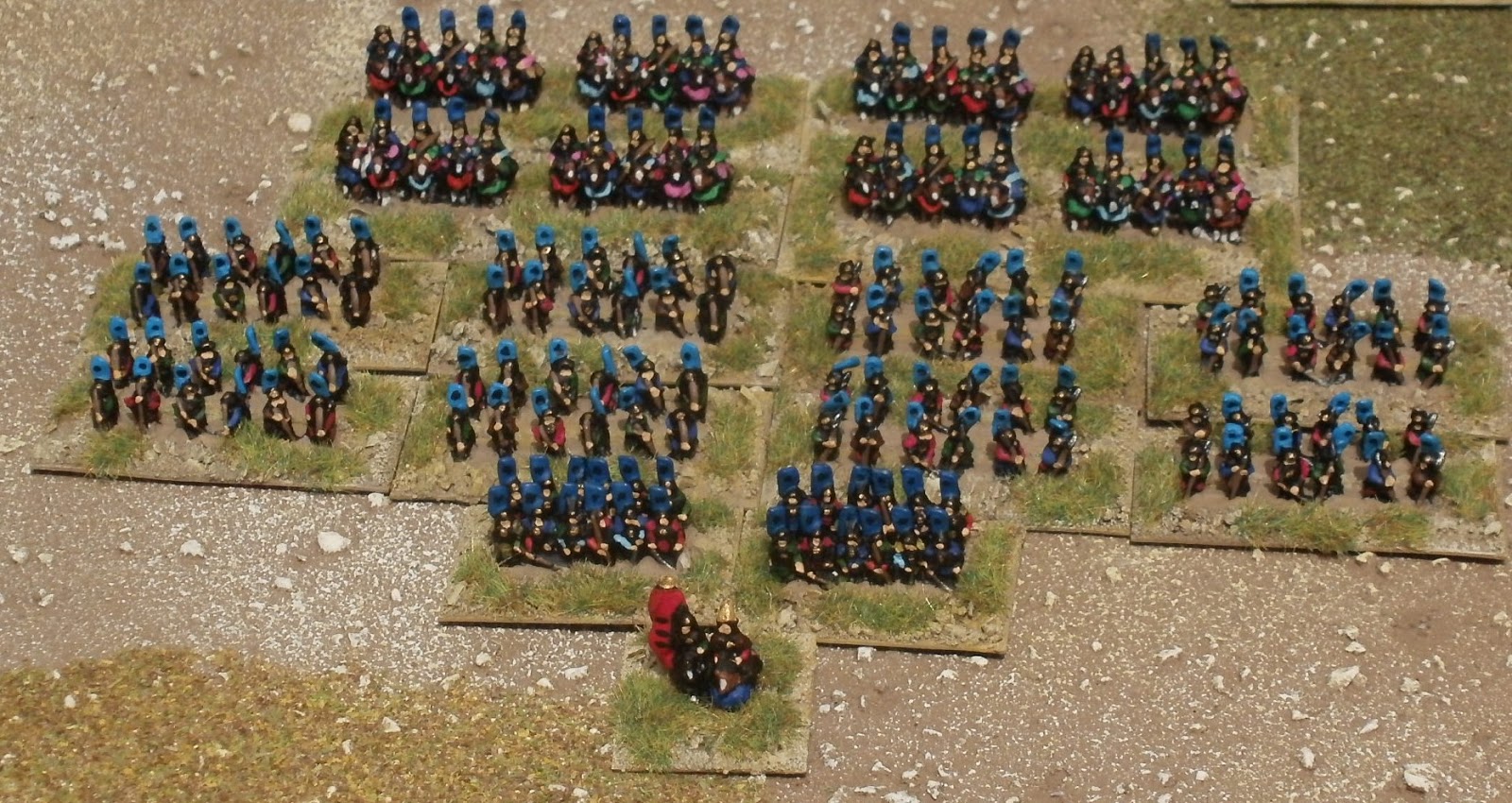

Chinggis15 Jun 2017 12:23 p.m. PST
2mm static grass on a light brown base with a few small pieces of clump foliage here and there. Here some of my samurai from Irregular Miniatures.
and
