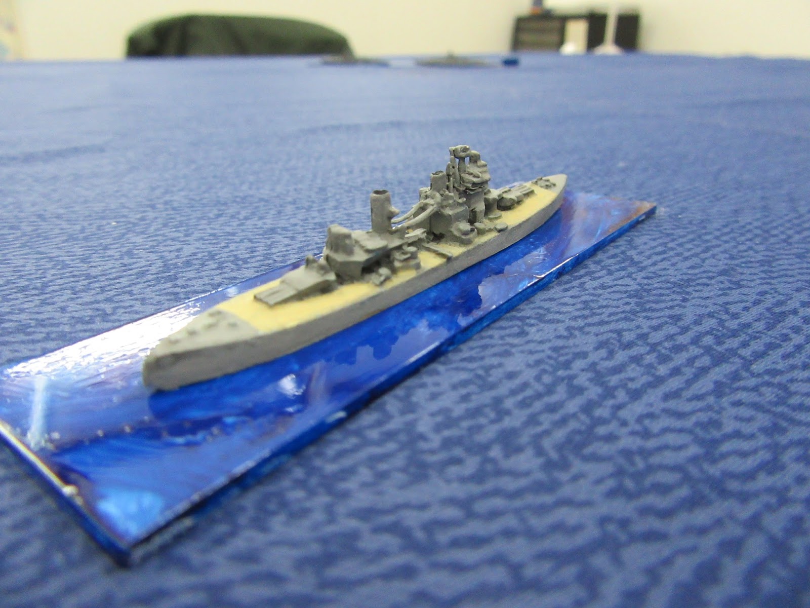

Temporary like Achilles27 Dec 2016 9:12 a.m. PST
With a game today necessity was the mother of invention, and I went with 25mm width and about 8-10mm clear forward and aft. The bases are still temporary, but this is the main idea.
Many thanks again all for your kind assistance!
