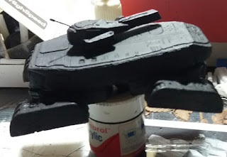

These are my latest creations.
I tried something new, loads of magnets to allow different setups according to need.
An IFV & AFV with inter changeable tracks & wheels . A heavy tank turret & Command vehicle.

Gaming wise , magnets give you the ability to dismantle vehicles when destroyed. Unfortunately 3mm ones are only strong enough for turrets. 5mm or upwards are needed for tracks etc.
They are really not too hard to build.Just decide on the general shape, saw or cut then stick card cutouts.

Another mod , grav engines.
Just remembered I had those for ages in the bottomless pit of a bits box.Most probably they're bits from a toy.

I forgot to add that the use of magnets depends on the size or overhang of the part used.
For eg. the grav engines( pic 1 ), being short require only 1 x 5mm dia whilst the tracks ( pic 2 ) being longer & heavier require 2 and 2 washers side by side. Unfortunately magnets act as a fulcrum on the longer pieces.
Still with experimentation you can have a good setup.
Another thing, wood drills are the best type of drill I found for seating magnets as they leave a flat hole rather than a chamfered one as in normal twist drills.
Always mark the bottom side of a magnet with a sharpie ( ie. the part you will apply glue to , as magnets have a mind of their own) . It is not the first time I had to dismantle them because of reversed poles ( ie. they push instead of pull ) and removing them is a pain , sometimes you have to drill a another small hole to the side of it & pry it loose. On small parts this is not always possible.
