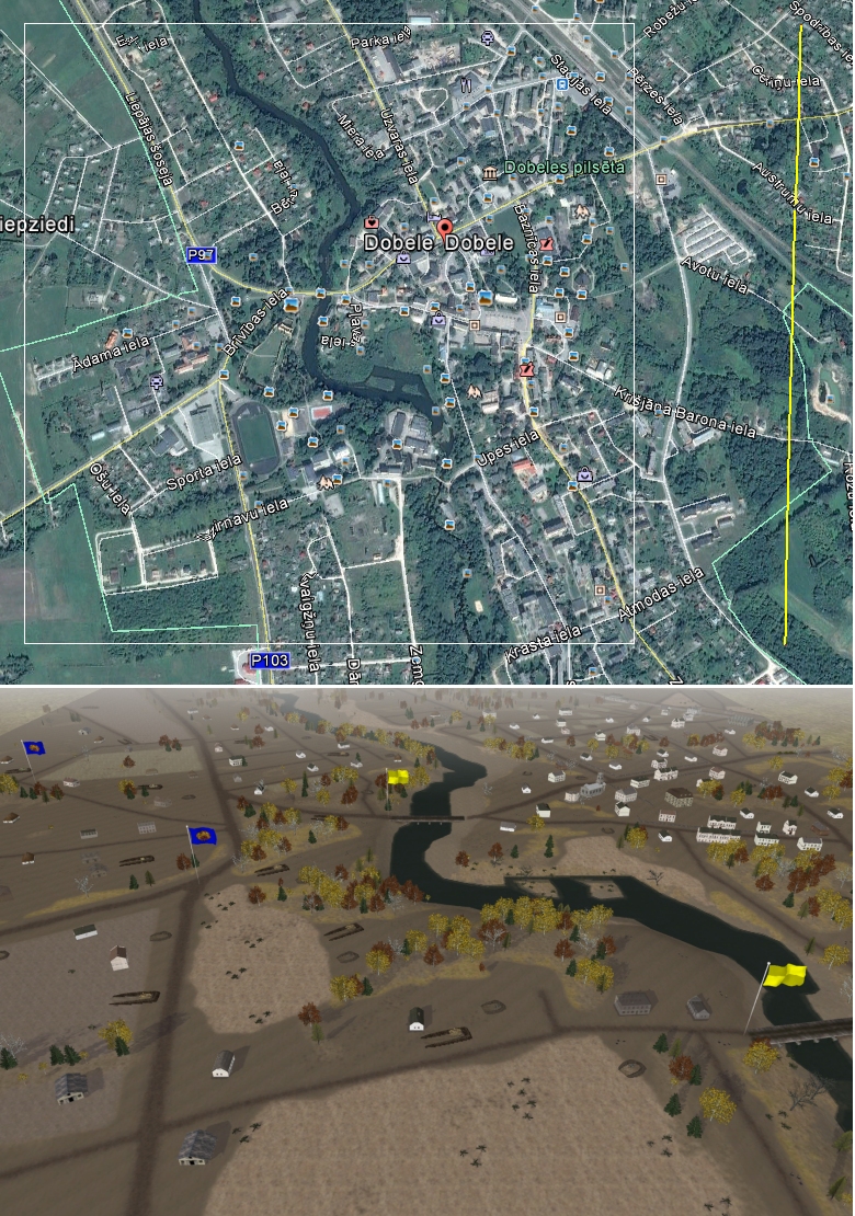

Mobius04 Nov 2016 8:25 a.m. PST
I made a Dobele scenario using the tanks and AT guns given. In this map the river divides the map in two, with Germans set up on the west bank and Russians entering on the east edge. There were still two bridges plus a ford through a marsh along the south edge. (see Google Earth)
The Russians had four company's of 10 T-34/85s and two company's of T-34 model 43.
The map has plenty of houses and buildings with trees along the river bank.
This broke up the Russian tank rush so they had to travel down streets in small groups. Plus each company entered the map at 3 minute intervals.
I played the scenario 4 times and each time it was an overwhelming victory for the Germans. There 8 Pak 40s and 6 PzKwf IVH were setup in trenches closest to the river. They were almost always totally lost. However, they had the most kills. The Panthers and Tiger was set up hulldown in dug outs about 100-200 meters behind the river line. An average only one was lost per game. Another 100m behind this line were the Tiger 2s. They were also hulldown in fortifications and suffered fewest hits and had almost no kills.
This was in contrast to the first tests I ran where 30 Soviet T-34/85 line up hub to hub and were able to salvo fire at the 11 German tanks in the open.

Thanks Captain,
The map is 1500m x 1500m of the river crossing at Dobele, Latvia. It is fall so no green fields.
Top map is from Google Earth. There is also a street view available. The river doesn't seem that wide.
