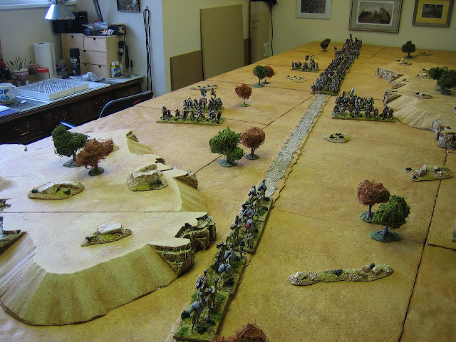

I've stuck it with PVA. I've been told it never actually dries because of non porous surfaces, but mine haven't fallen apart yet. I did take the precaution of spreading the glue on the outer surface so that it dried, like paint, across the gap.
These hills are two 1" thick bits stuck together with PVA, and looking closely you can see the join.
