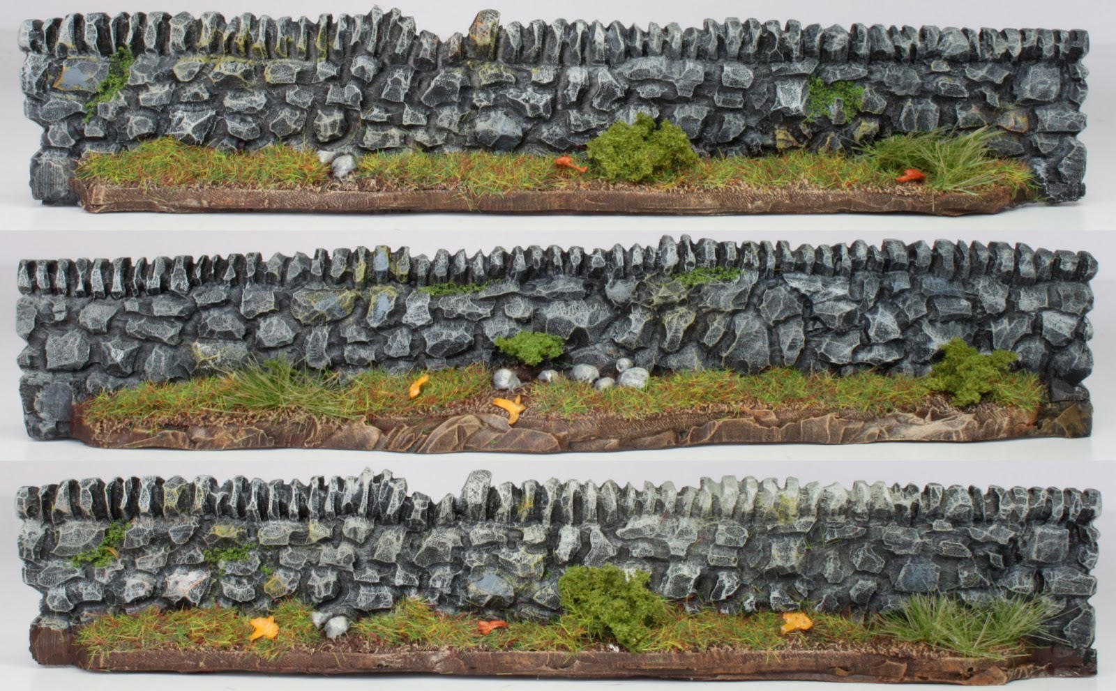

In making terrain for 28mm AWI games, I had one thing come up that raised a question.
I live in New England, and I've seen thousands of old stone walls over the years, many dating back to the 18th Century.
I recently bought some stuff from Redoubt Enterprises, they have a pretty decently priced stone wall set for 18th Century gaming. But when I got it I saw a detail that has me wondering;
My question is, did stone walls in America ever have the stones piled on top vertically like they are on Redoubt's walls? My hunch is that it's more an English and European thing. But I don't know nearly enough about the history of those types of walls. I know that one big misconception about New England is that stone walls were used for marking property boundaries and field boundaries, when it reality many were there simply because it's where farmers stacked the stones along a line when they were clearing forest and clearing land.
Would appreciate what anyone might know about this particular style of wall and if it could be used for AWI games.

JasonAfrika03 Jan 2016 10:02 a.m. PST
In Philadelphia that is a very common wall design…except there would be gaps, kinda like crenellations in the certical stones. Whether it dates back to the18th Century is hard to tell though. Alot of New England stone walls were laid dry, ie. without mortar, so the vertical thing wouldn't work. I would use them in a game. Anyone who called you out on incorrect stone walls should be banned from your home for life.
Early morning writer03 Jan 2016 10:03 a.m. PST
Personally, I've never seen such a stone wall, even in photos. That would not stop me from using it in a game, plenty of immigrants in America then and who knows where the farmer who built the wall came from. I'm guessing that style is designed to deter animals from crossing it so I'd suspect use in goat country – or maybe deer deterrent. Curious to find out where such a wall was used and why.

They are not common, but there are some in the mid-Atlantic states.

Dunno about New England but that style of stone wall is very common in old England!

..and "the vertical thing" DOES work on dry stone walling – literally millions of examples littering the north of England and beyond..

Seems like in England at least they did figure out ways to do the vertical stacking without any mortar, as Chokidar mentioned above. Very interesting!;
jowady03 Jan 2016 11:55 a.m. PST
I've never seen it in Virginia, Pennsylvania, Maryland, or as you mentioned New England (or for that matter the Azores). Redoubt, being an English Company either made them more for English terrain or they figured that a stone wall is a stone wall and went with what they were familiar with.

I've seen a lot of walls with the vertical stones on top in central Kentucky.

The dry stone walls used to be quite common in the Kingston (Ontario Canada) area. A legacy from our British colonial era and immigration no doubt.
Recently, they have revived the craft on Amherst Island not too far from Kingston. I remember seeing a TV program showing a master dry stone builder teaching about a dozen people of various ages over the summer months. BTW; the wall they were re-building was similar to the Redoubt wall that you have pictured above minus the top layer of stone.
So, I expect that these dry stone walls were quite common in North America wherever there was a British influence and plenty of material. Accordingly, I certainly think your walls are most appropriate for the AWI period.

I have never seen that type of wall in NY or any part of New England.
In fact it does not look like anything that I have ever seen in America.
I would not use that.

It might be more appropriate around a church or meeting house of some sort.

As noted above, Britain is covered in stone walls, many very similar to those above, including dry walls with vertical topping stones. Many of them are very, very old, so it is not inconceivable migrants to the US knew how to build them.
It isn't hard, a few hours instruction and you'll be dry stone walling away…
