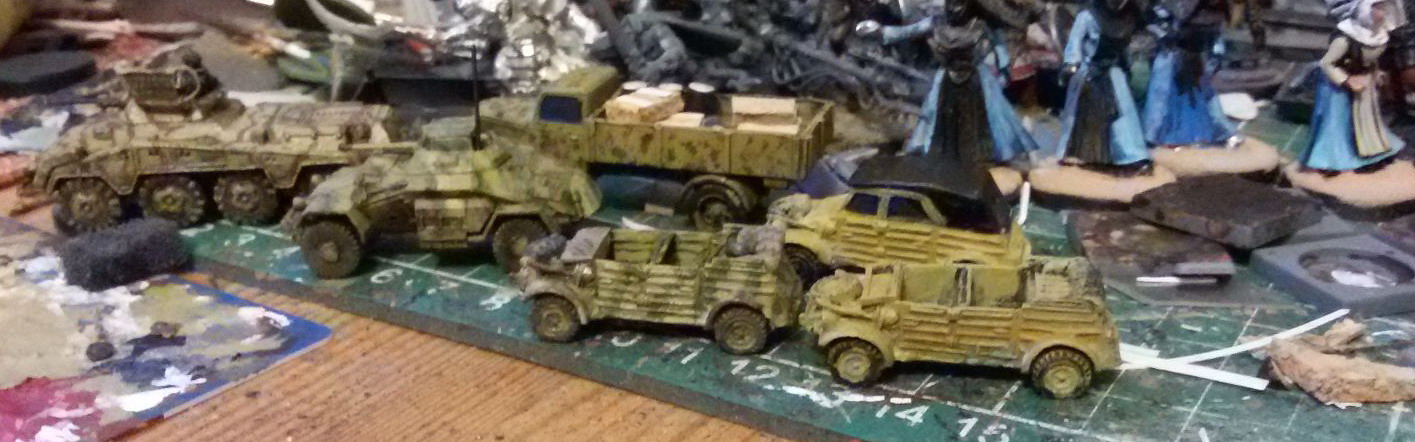

If you are wondering what is easiest and safest way to clean off vehicle bases that are cast on some of the Battlefronts vehicles check out my blog post on this
Quite easy job with a right tool.

AWuuuu25 Mar 2015 1:58 p.m. PST
Bases are perfectly Ok as conscious decision.
I am not enemy of basing itself here.
I see merits of basing – for example a consistent height with miniatures.
But mixing based and unbased vehicles is worse of the both worlds.
It just don't work well as it skews scale consistency in vehicles themselves.
I decided to skip basing for better looks with the terrain.
As I play mostly Chain of Command in 1:1 terrain scale I don't want to make compromises with dragged bases.
But If all your vehicles are based I have to admit I wouldn't bother with rebasing (but I quite like Bf basses and have big bunch of them from two Open fire boxes – I just couldn't find good use for them yet :)
@Chuckaroobob
Really simple, easy and fast. On slow speed its even not that easy to damage the models by accident (what is certain with the saw tools for Dremel)
Just use some glasses and mask, and do it outside – that dust is nasty.. I had to shower my hairs to remove it completely.
And after the process – models are dust white, but wash of running water and toothbrush solved this completely and effortlessly.
