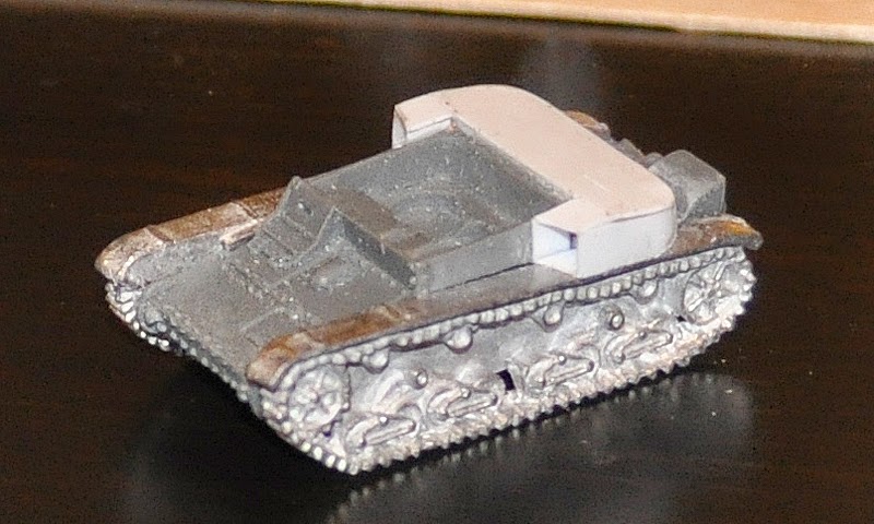

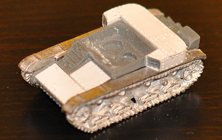

For the chassis, I've started with the Battlefront T-26 obr 1933 (SBX21) as it provides a reasonable platform for modification. It even includes the shield over some of the engine deck screens. The first step was to remove the side stowage boxes and add the air intake structure so characteristic of the Polish tanks.
So far so good as it integrates with the tracks:
The next step was to begin working on the superstructure of the tank itself, as the T-26 and the earlier Vickers have several differences. I removed most of the detail on the upper hull front and replaced the plates with thin plastic card. Then I added rivets individually. As you can see from the photo below, the rivets are exceedingly tiny!
The completed front plates:

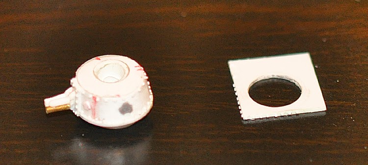

I've now moved on to the hull top and the turret (for the single turreted version). I'm using some 3rd party details on the turret at this point, but they're a tad big, so I'm thinking about taking them off and going with my own scratch-built ones. Turret still needs a little riveting (on the other side) and detailing…

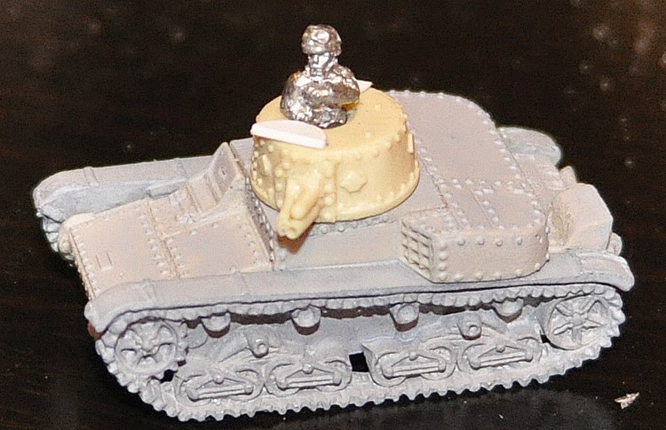

After a prolonged battle with my casting components, the first test casts of my master for the Polish Vickers are in, and overall I'm about 95% pleased with the good ones. I'm still not completely sold on both of the grates on the air intakes, but I don't have a "Plan B" at this point. I have a couple of ideas which I may go back and explore as time allows. Unfortunately my RTV hasn't been cooperating, and the lifetime of the molds has been short. I only got two near perfect casts of the hull before the first mold broke down, and the second mold had mixing issues from the outset. I've gone ahead and made up a few more hulls just in case I can't get everything to behave.
However, the ones that do come out actually do look pretty good:
I was going to use a 7TP commander, but they looked undersized and poorly defined… so I borrowed one from a Somua – uniform and helmet seemed to match the Polish Black Brigade tankers well enough…

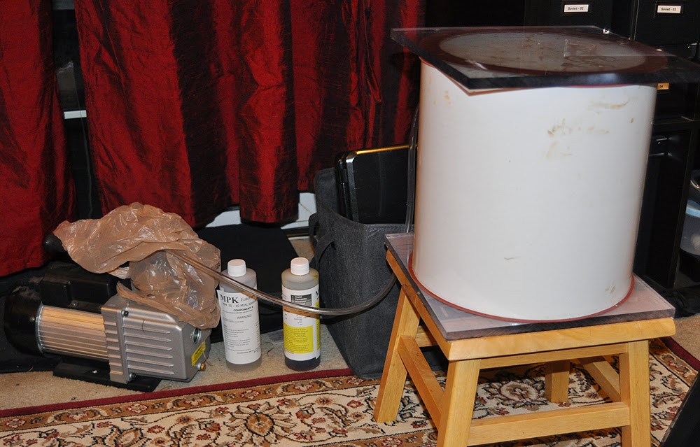

So you say you want to know how to cast – a high level overview is now at the blog… I cheat and use a vacuum system:
That being said, I'm getting some really good casts at this point, though the resin takes a bit longer to reach full cure (which isn't necessarily a bad thing – it's just a "slow" thing)

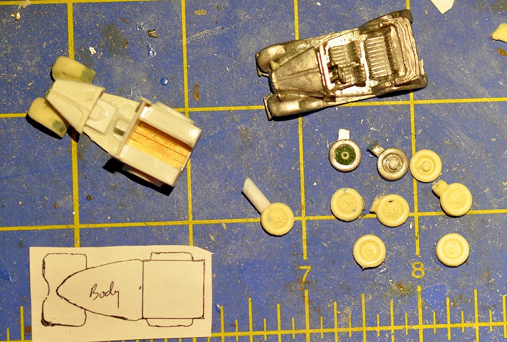

I've updated the 508 staff car and I've been working on scratch-building the 518 truck / field car.
I've added rifles to the staff car, and I've modified the blank wheels with one with the distinctive radial pattern seen on the real thing.
On the 518 truck, the bed is done and the hood / engine covers are done. The basic roof shape is cut out but not attached. The doors, grill, and final details are not yet done.
I've also been making up a bunch of wheels – radial pattern wheels for the 508 staff car, and some of the double hub wheels for the 518 truck.

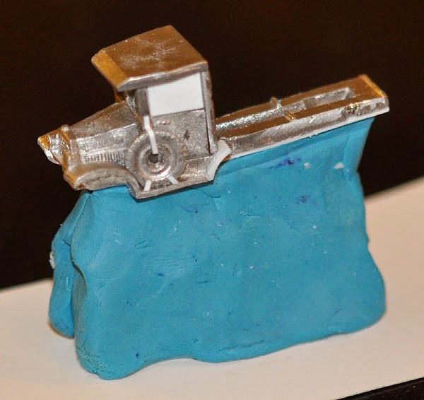

So here's the update… and I've got good news and bad news.

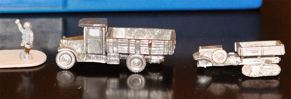

First the bad news, the Quality Casting halftracks and True North trucks (which should share the same chassis) look like they're completely different scales… and I'm not talking 15mm vs. 1/100th.
Soooooo….. Do I try to get some Quality Casting trucks and deal with a slight difference in scale for the trucks and halftracks (with everything else), or do I try to convert the 621 truck to a halftrack (which would mean making my own suspension and tracks)? I'm not sure I have time left for either option. A third option would be to drop the halftracks entirely which would sort of spoil some of the tactics I'd planned on using for the list.
On the good news front – I've solved my RTV and resin issues… and now have a lovely test cast of the 518 truck:

VonBurge27 Jan 2015 2:11 p.m. PST
I think the True North tuck looks more proper to 15mm. The Quality Castings halftrack is just too small to be usable for me. I'm sure you can handle the track and susoension conversion given the modeling skills you've displayed already.

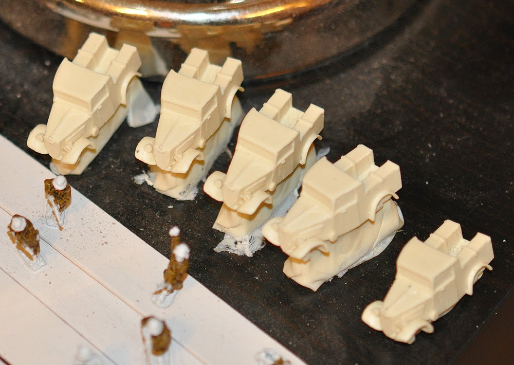

Making some slow progress – unfortunately my 518 truck mold crapped out – but I do have five done… need a few more though:

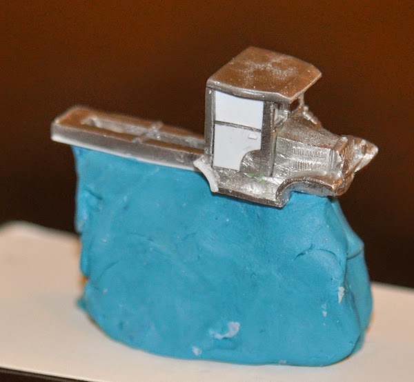

Don't you just hate it when you realize that your tow vehicles aren't quite right… turns out I needed yet another variant of the Polski-Fiat 518, the Pz Inz 302, for my 37mm guns (I'm still going to use the 518 as the command vehicle).
I ended up carving down one of my resin 518's to make this beast – it's just about ready to cast…

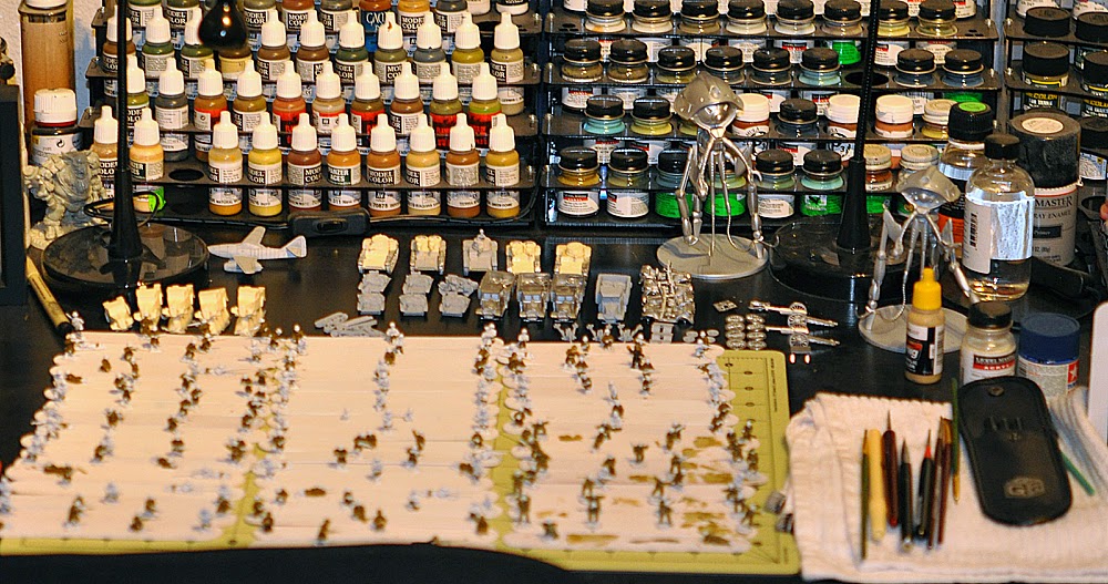

Way too much primer on the table – hoping to fix that situation this weekend!!

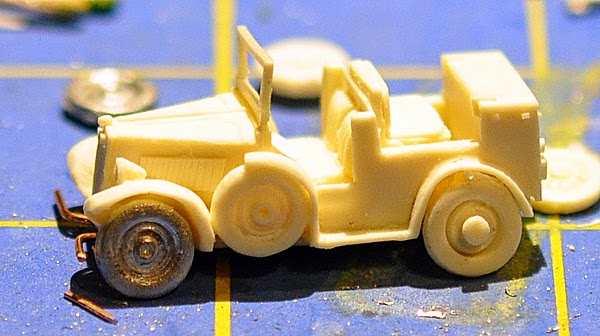

The Polski-Fiat 518 is also ready to go, the spare tire may need to move up or down just a bit, but it isn't molded in like on the Pz. Inz. 302. I also need to finish the bumpers on these. I'm using HO scale dimensioned wood for the rails and copper wire for the supports:

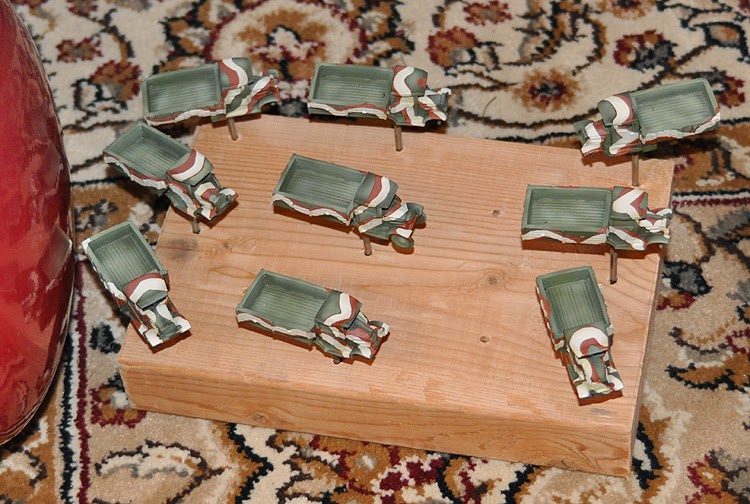

fingolfen16 Feb 2015 3:45 p.m. PST

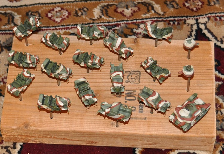

Now on to the painting part of the process… I've spent the weekend working on the paint jobs for all of the various vehicles and guns… whether I get this all there by this coming Saturday or not is anyone's guess, but I still have Thursday and Friday off to try and finish it all up… wish me luck!
For the modulation colors, I'm using AK interactive Dunkelgelb, Rotbraun, and Soviet Green. Plan is to follow up with a filter. I started "light" on the yellow and red, in retrospect I maybe should have started a shade darker and built up to the same top coat, but I think after the filter and wash it should pull together with a little highlighting.
Guns and various gubbins:
The field cars and tow vehicles (+ one tank and a couple of turrets):
Trucks and halftracks:
Vickers and TKS:
