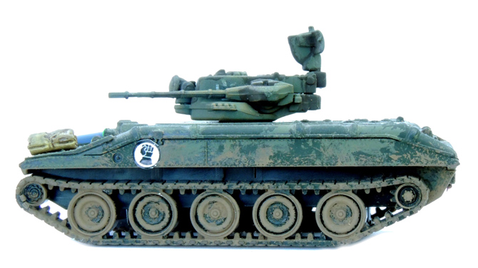

"V4-Wildcat" – Medium tank
Chassis = M551 ‘Sheridan' (Z254)
# Light Recon = Marder turret (Z262, Z475, Z566)
# SP MLRS = Roskopf E.German ‘Ozelot' (or Nebelwerfer?)
# SP.AA = Takara WTM 1/144th ‘Gepard' or Japanese Type 87 equivalent

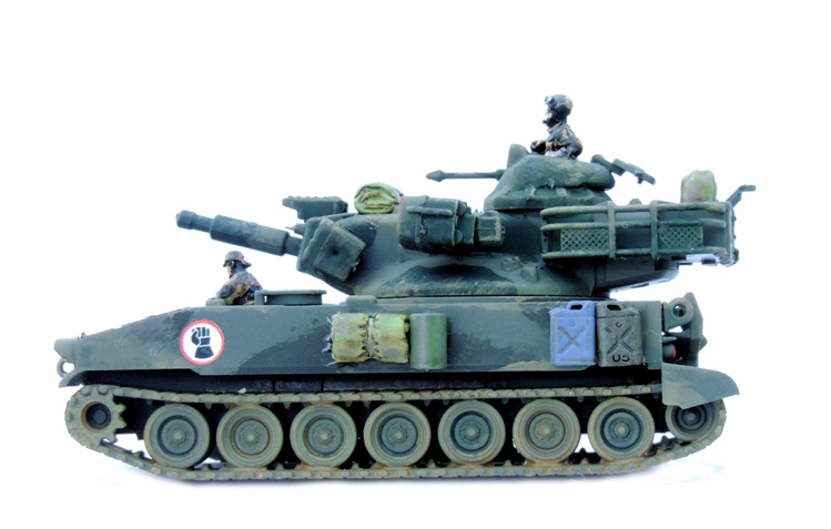

"V6-Hellcat" – Heavy tank
Chassis = M109 (740524); beware the smaller M108 version
# MBT = M60a2 'Starship' turret (741125)
# ARVE = M109 turret mounting M48 bridge! (Z219)

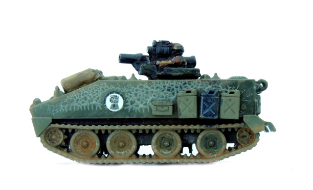

"V20-Tigercat" – Light general-purpose AFV
Chassis = M114 (Z253)
# APC = ‘Hummer' one-piece crew options from Peter Pig (ATGM, HMG, 40mm Gren)
# Medium Recon = Takara WTM 1/144th ‘Merkava' turret
# SP.AA = Takara WTM 1/144th ‘Gepard' or Japanese Type 90 equivalent
# Auto-Mortar = M114 turret + shortened ‘sleeve' for HMG!

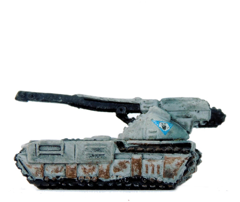

"V22 – Bobcat" – SP AT gun
Chassis = MechWarrior – 'Enyo' tank

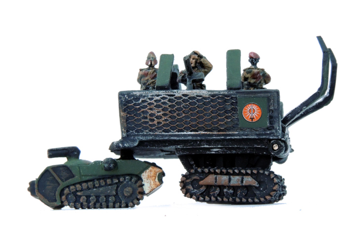

Civilian all-terrain transport " SKD " (or ‘SKareDy-cat' as it is known unofficially to PRA troops!)
Chassis = MechWarrior ‘Saviour' Repair Vehicle
Vosper16 Sep 2014 6:28 a.m. PST
The V6- Hellcat looks pretty neat for such a conglomeration of parts, and an interesting use of the "Starship" turret.
LoudNinjaGames16 Sep 2014 5:32 p.m. PST
Are the smaller tracked vehicles and the civilian transport supposed to be remote controlled or just really tight cockpits?
-Eli
John Treadaway16 Sep 2014 11:33 p.m. PST
I think they're remotes
John T
Peter Merritt17 Sep 2014 3:41 a.m. PST
Ta.
The double-tracked 'SKareDy-cat' I assume is remote controlled (I already have an R/C toy which can do this from a phone app, so I figured the 24/26thC would be ok). This would simplify and lighten construction of the drive unit, allowing for a degree of robotic/autonomous function (i.e. 'take this load to the dump'). Not surprisingly, developing the Slammers concept originally in the early 1970s David Drake didn't think much of computing power back then!
The 'Bobcat' SP/AT gun model is just large enough for a semi-prone driver (it's bigger than a 15mm Jeep, more like the WW2 Bren-carrier – which the Germans also used with a 37mm on the back). My idea was, as an infantry support unit, it is electric-powered (for semi-silent ops) and operated remotely once deployed, a little like some of the early generation of real-world ATGM (i.e. Saggers, Milan, SS11 etc), which all featured remote operators. And with the early failure rates/erratic flights, who could blame them?!
