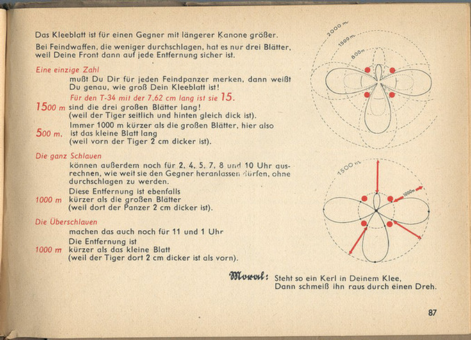

DS615116 Apr 2014 3:58 a.m. PST
Perhaps we wargamers are too fixed on official penetration charts and see only that raw data as being being the vindication for design value.
There is no "perhaps" about it. This is exactly true, and a real problem.
Why didn't it have sloped armor? Because it didn't. And that's the end of that.
