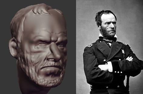

Sculptris is good at stuff like this:
The problem? How do I know if the subtle details of his beard will show up in the final print? How do I know if his eyes, or nose, or anything else is the right size? I don't. More on that later.

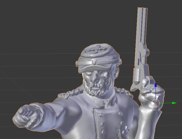

The second thing I tried was Blender. Again, free is good. The problem with Blender is that it is the most bafflingly complex and non-intuitive thing I've ever seen. There's no way I can use Blender to knock out a human figure. Not going to happen. I just don't have the expertise. But after I few hours learning I could use it to produce angular objects like firearms. My plan is that I will sculpt all my soft, organic shapes in Sculptris, then import the .OBJ into Blender, where I will add the guns and swords and other rigid bits. I like to say that using Blender to sculpt a pistol is a bit like using a fighter jet to pick up groceries. The tool is very powerful and very complex, almost to the point of overkill for what I am using it for. But it is good, once you get the hang of it, and it gets the job done.
Check out this guy. Notice how the body, hat, sleeve cuffs, etc are all soft and kind of mushy? That's Scultpris. The gun (hard, rigid, lots of sharp angles) is Blender. That's the difference. I wish I could use Blender for everything, but I don't have the time or the training.
