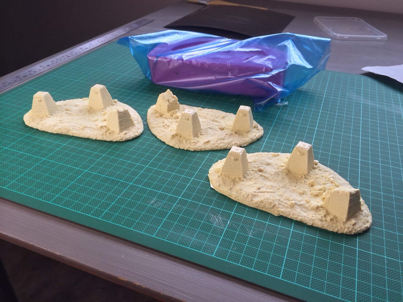

Otherwise resin is always an option but I'd prefer white metal. I've got a bit of experience with resin casting and recently scratchbuilt and cast these tank traps…
