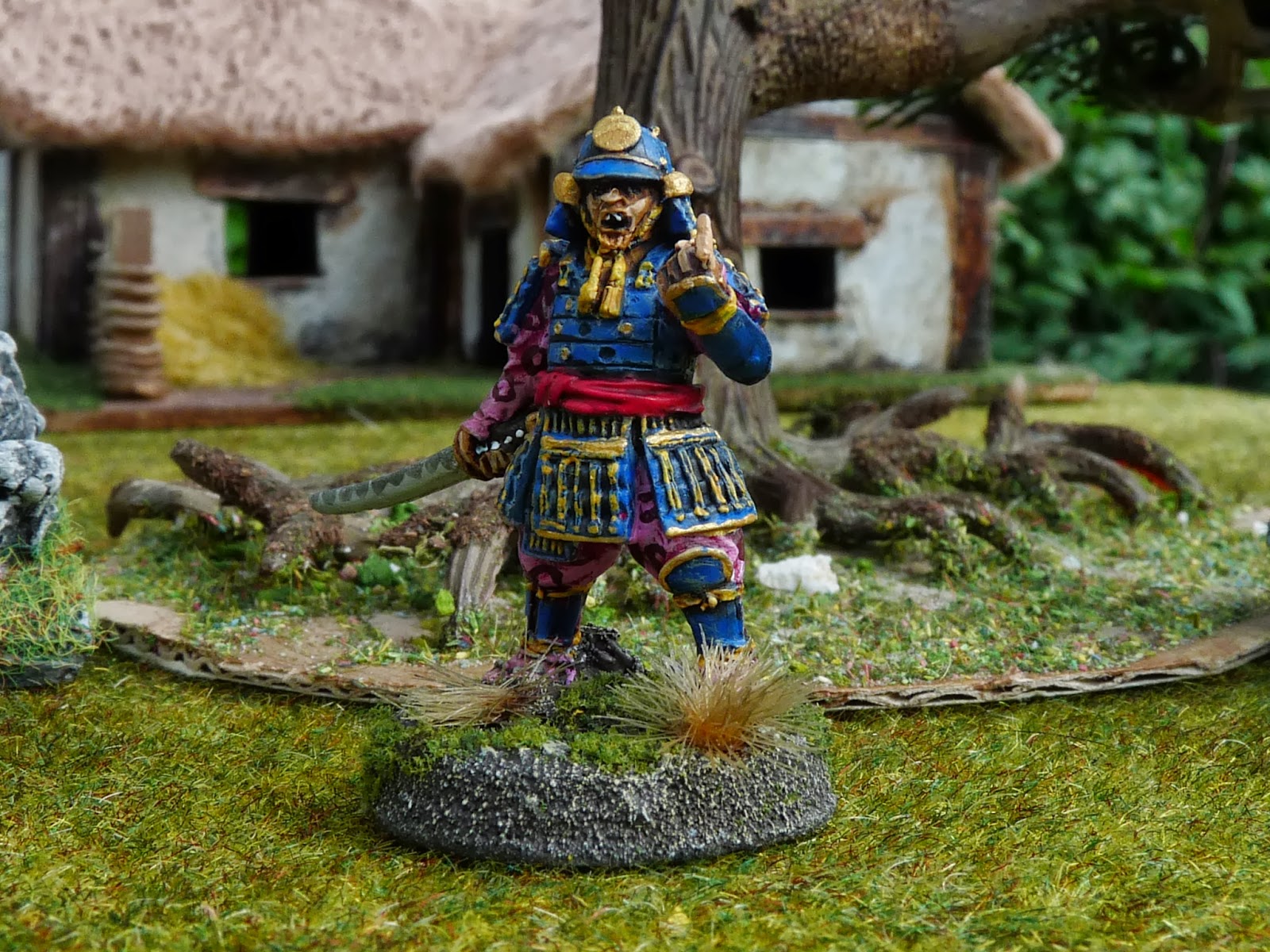

There is no really easy way to do it, but assuming my result below approaches the effect you're after here's my take on samurai:
Paint the armour a dark version of the eventual colour (black only if you aim for black/dark grey armour). You can always black-ink the crevasses later.
Highlight the plates with the mid-colour. Drybrushing might work here only if done very subtly. Better is just painting the middle colour on the higher surfaces. Use very little paint. It is better to have to paint the same surface twice than applying too much paint.
Highlight with the light colour. Dryrbrushing subtly here is the way to go.
Find a contrasting and preferably complementary colour for the lacing. See link for complementary colours.
Apply this colour to the lacing with a very fine brush. Use a magnifying glass. Don't drink too much coffee before trying this or your hand will not be steady enough. Time is on your side. Haste is the enemy. Just paint one knot at a time and take your time. When you are feeling brave you can highlight the lacings as well.

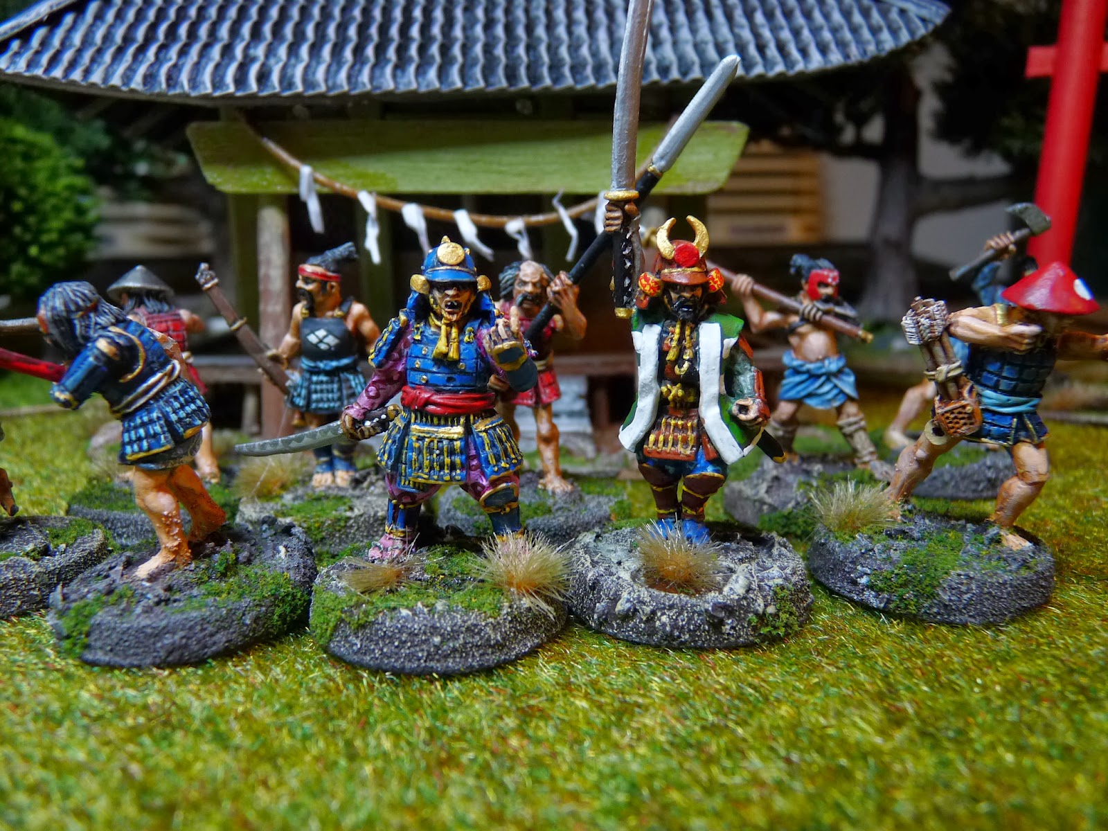

Pijlie02 Jan 2014 1:16 p.m. PST
And I thought, what the heck. Let's see what I can do with some artificial white light. Not great pictures, but they will do:
