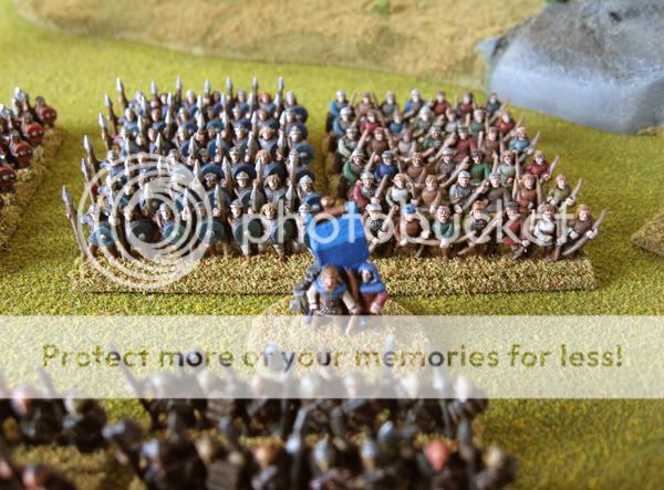

Nicely detailed. I suggest a light wash of Vallejo Smoke or some similar brown wash. Don't overdo it. Just enough to create a little shadow in the folds and face features.
This isn't the best photograph of Bard's men from GW's BoFA, but I think you can see how a light brown/black wash can mute the colors a little and enhance the detail.
