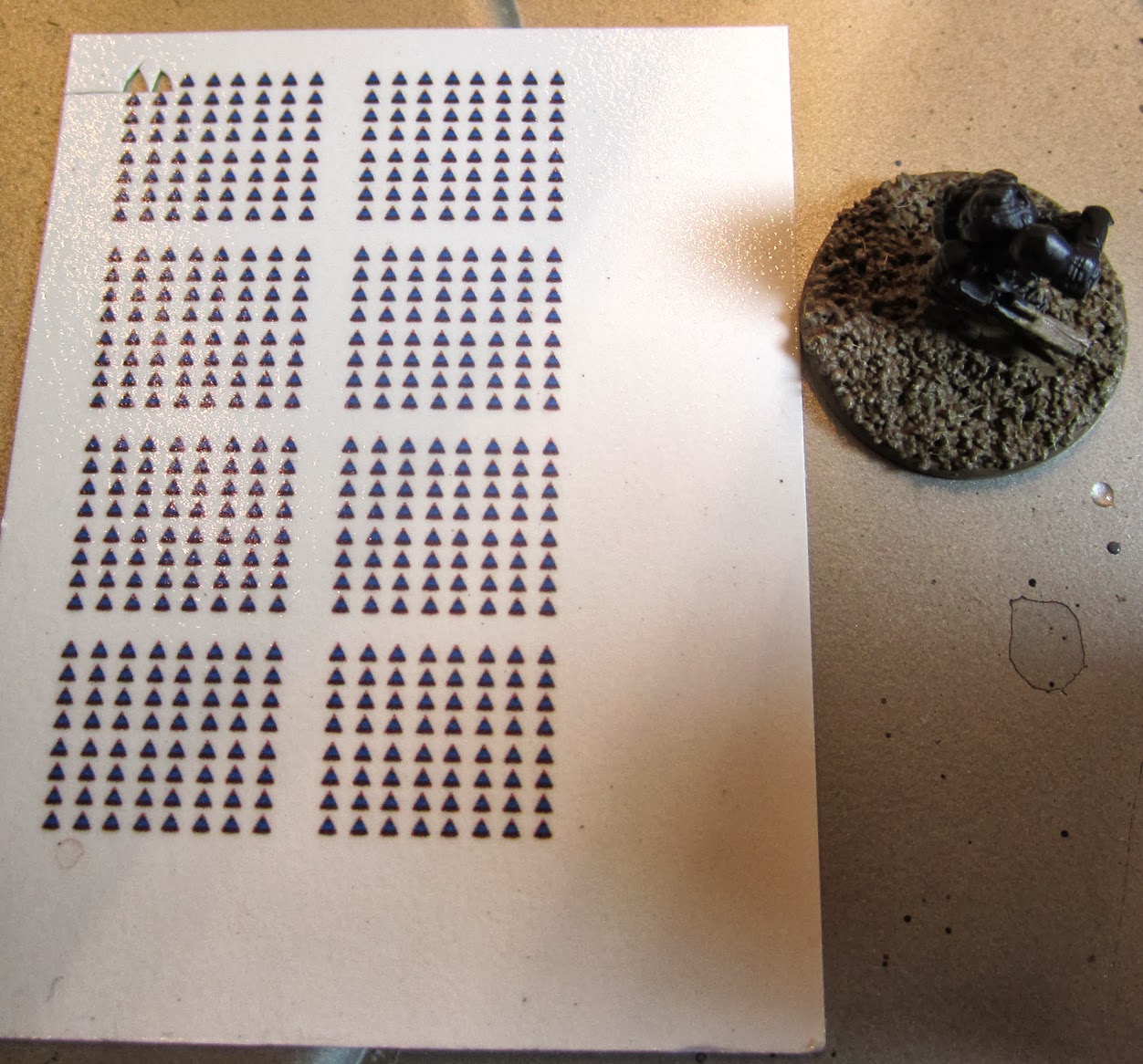

I picked up an inexpensive 25-pack of letter size decal paper, and with some photoshop skillz I made this logo:
Then, I had to figure out how big it needed to be. The shoulder pad of my hell divers is about 1.5 mm tall, so I settled on 1mm tall decals.
I printed on the sheet with my inkjet, then I used three separate coatings (allowing each one to dry, thin coats) of the testors decal paper setting spray. Here is an 1/8th of the page I cut out:
(Next to a figure based on a penny)

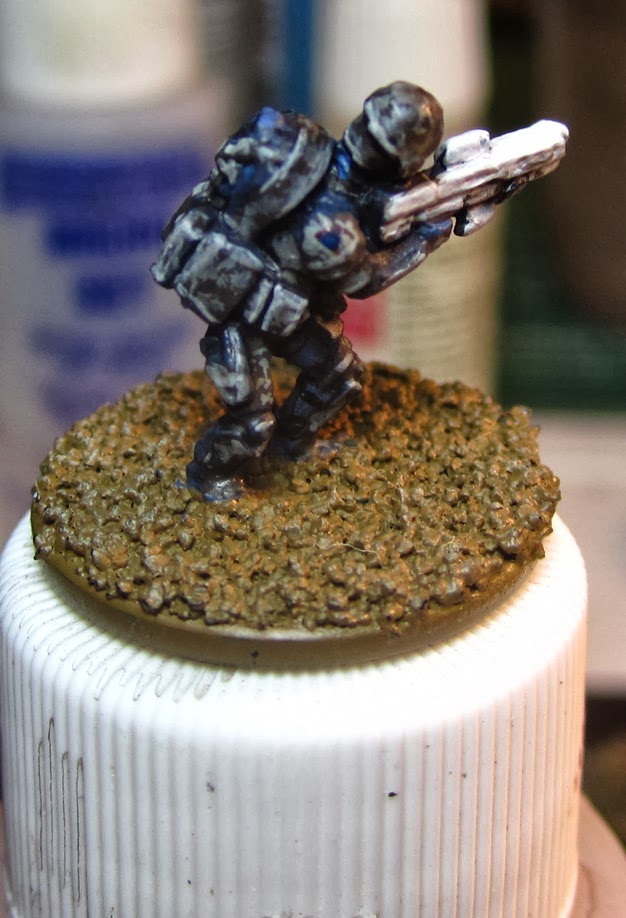

And, after using soaking it in water, placing micro-sol on the shoulder pad (after a gloss coat) and then using a brush to move it over, I coated it in micro-sol again and then a flat coating. This is what I ended up with:
I'm very happy with it! I don't think i'd do a million of them, but it really didn't take too long. Also, If I had it on a mini that was a vastly different color I think it would stand out even more.
What do you guys think?

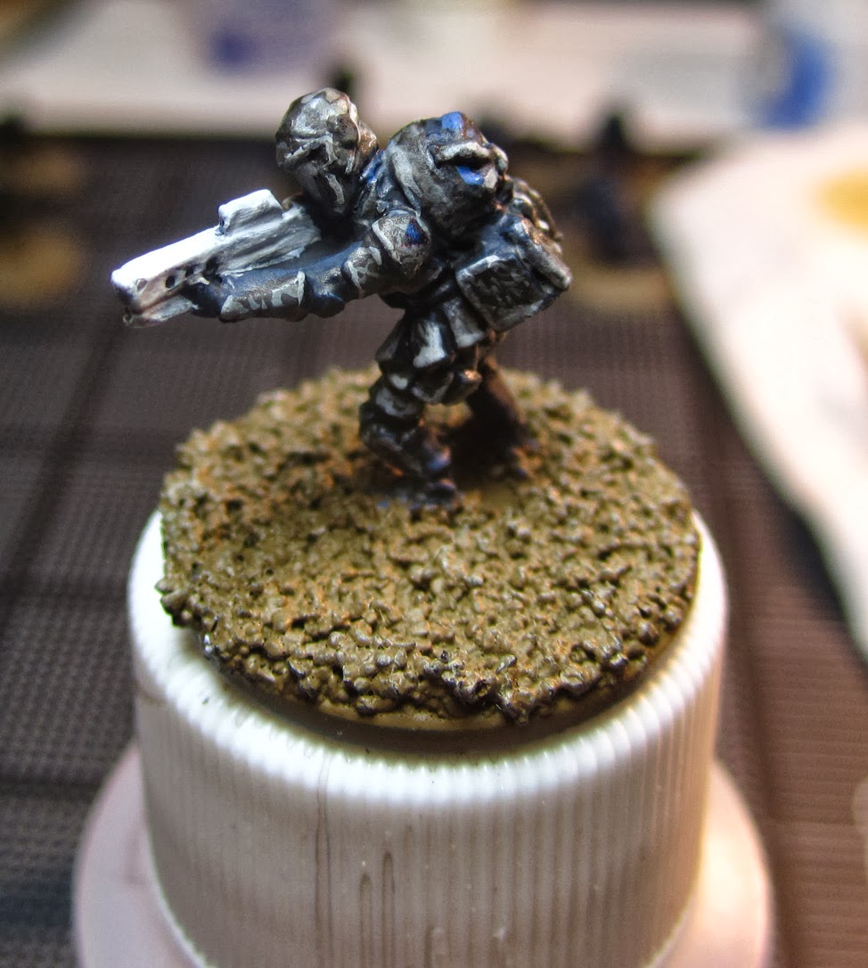

I painted one up with a lighter color (a khaki). I've very happy on how the decal turned out:
I'm painting a squad up in grey, i'll probably paint the shoulder pad a light grey first before the decal.
