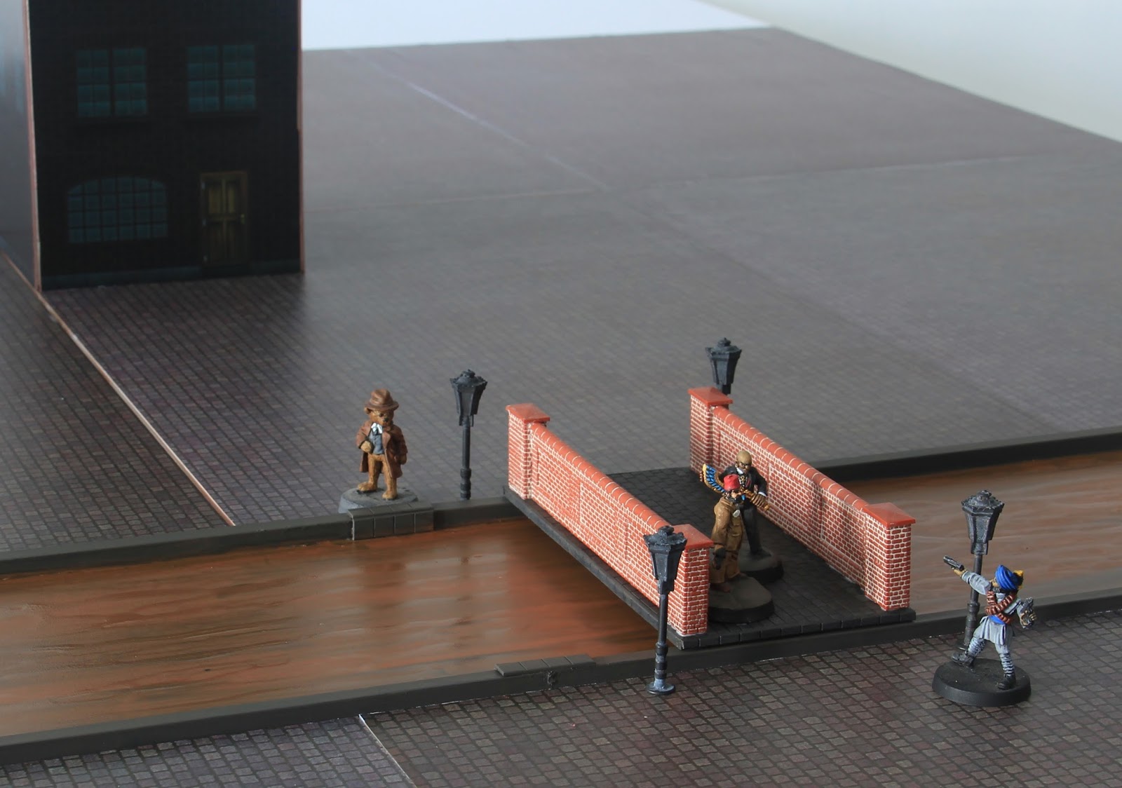

For the streets the options are to go for 3D or print.
3D can be expensive depending on the area you need to cover and the exact type you use, e.g.
Print you just find a suitable file, print it on A3 or A4 sized paper, then glue the paper to some sort of surface.
This is what I did:
