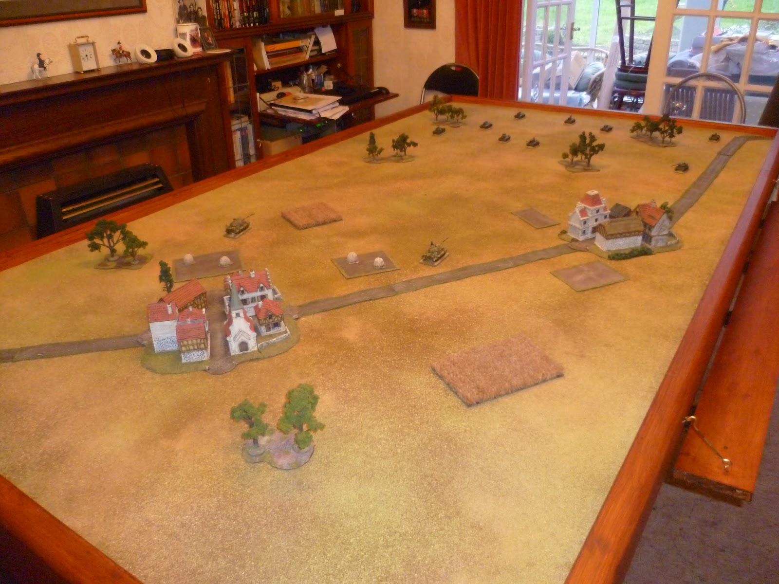

Hi all, the table is finished and I've posted an update on the blog.

That really came out nice. How sturdy is it after adding that heavy of a top?

Hi James,
The table is rock solid. The two frames don't add much in weight, but really lock down the mat.

What did you use for the inner sheet of the table, insulation board?

Mapleleaf31 Mar 2013 1:00 p.m. PST
It's a great table and is tempting me to do something similar. The one question I have can you take it down and stow it someplace when not needed or is it more permanent. I see wheels on the old table tennis so can you push it off to the side or can you fold it?

Ok, thanks for the kind comments, and re the questions;
Fred12df, yes the base is insulation board, follow the link on my blog to Lord Ashram's blog for detail on the design.
Mapleleaf, no the table is fixed once I put the outer frame on. I don't plan to move or fold it.
Black Hat, yes the terrain mat is from Terrain Mat. It looks great, although I think it will wear at the edges over time so I will have to consider an alternative.

Sgt Slag01 Apr 2013 8:34 a.m. PST
Looks fantastic. Just an FYI: the table-tennis undercarriage is not the most solid, dependable support system. If it works well for you, great. I started out with the same, but the undercarriage did not last very long, as I was folding it up, frequently, and rolling it aside, in my basement. If your's works, good on you, and never mind the rest…
If you find it faltering with time, you may want to upgrade it with folding table leg assemblies, which can be found at hardware stores, or DIY stores, typically. I installed a pair for each half of my table. The particle board tabletop was too thin to sink screws into, so I used either construction adhesive, or wood glue (can't remember, it was more than 10 years ago), to secure 1-foot squares of 1/2-inch plywood to the underside; I then screwed the folding leg assemblies into the plywood.
To keep the two table halves secured to one another, I used a pair of steamer trunk type latches/hasps, one half on each side; they were slightly spaced too far apart, so that when clasped, they really snug the table halves together.
This allows for the two halves to be separated, legs folded flat, and the tables can be removed completely, if necessary (they're actually quite heavy, IMO, so they are only taken down if necessary…). They also serve as a large, 9' x 5' table, if needed, for family gatherings (mine is covered with different things for the gaming surface, as needed, no trim around the edges). Cheers!

Sgt Slag, I was interested in your table undercarriage problems. My table has always been in situ and I've been using it for 20 years with no problems, which is why I'm looking forward to the next 20. The lower legs are also stressed with wooden slat shelves that whilst providing extra storage also give added rigidity to the whole structure

Jonathon, how is the terrain mat constructed, is it a canvas base with flock glued on? Or is it something more hi-tech? I'm just wondering a) why there are folds, surely it was rolled for postage and b) why its cracking. Id hope they used some flexible material in the construction. I see its a 7 week lead time, so unless they are flooded with orders there must be something that is hardening or drying into the mat base?????
Lord Ashram puts hills etc under the mat. Maybe the mat would last longer if you just left the mat in situ and put hills etc on top of the mat, suitably flocked to blend in with the mat?
If you are looking for mat mark 2 there are loads of vids on You tube for mat making.

The mat base is a sort of nylon mat you see used on flower beds to stop weeds pushing through. The covering is a mix of I would guess paint, possibly glue and texture. I've noticed a bit of cracking particularly on the edges that go over the foam board beneath. We'll see how it goes and I'll post my experience as we go. Thanks for the links.
Mike, I don,t think the occasional use of the odd tree or hedge/wall section should be too detrimental to the mat. I am planning to use dress pins on the bases and only use them when they help add to the look of the table. The rest of my terrain will be free placed. Check out Lord Ashram's site to get a feel for the effect, it's very impressive

My canvas-and-latex-caulk terrain cloths have withstood over a decade of pinning, folding, storage and transportation without showing much wear. Where they do wear, it just adds to the natural variegation of the ground cloth, since I use a mud-colored caulk.
As for the table support, I have a folding leg-and-stringer table (since I don't have a dedicated game room):
but I've pretty much given up on that in favor of inexpensive folding tables. Both types are light and easily storable when I need the space for something besides gaming:

Rwphillipsstl, I used this type of hasp to secure the two halves of my re-based Ping Pong Table together: link. I spaced the two halves a few extra millimeters apart, to ensure they pull together tightly, when clasped together; by locking the two tables together, they are more stable; to secure your tabletops to the under-tables, you could go as simple as drilling holes, and using wooden dowels for pegs, or even peel-n-stick velcro strips. I used two hasps, one on each end of the seam, to both align, and secure, the two tables together. It works superbly, they were inexpensive, and easy to install. Cheers!
Personal logo War Artisan Sponsoring Member of TMP14 Apr 2013 4:39 p.m. PST
Rwphillipsstl: You might consider using insulation board instead of hardboard or MDF. It's much lighter and will easily hold the weight of the terrain and figures, as well as hefty gamers leaning on the table:
Mine hold together just fine with only the terrain cloth draped over it, but I have used fasteners like these in the past, pressed into the foam to hold them together:
