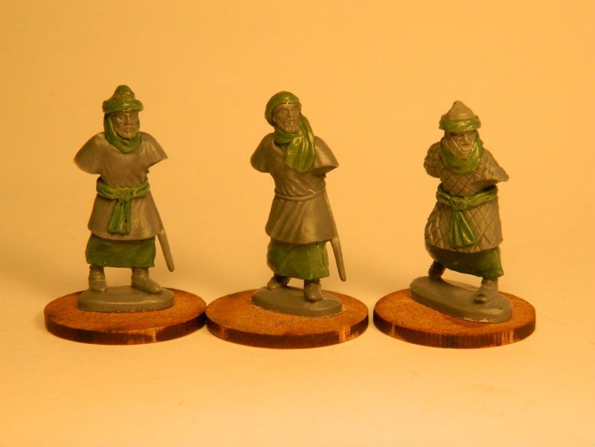

I have used WGF Saxon Fyrd heads on the Conquest bodies. Some filing is required but it is easily done and they look great. I am making Andalusians with them. The two on the left have the WGF Saxon heads the one on the right a WGF Persian head.
French Wargame Holidays07 Jan 2013 9:04 p.m. PST
nice one codsticker, a good use of the figures!
