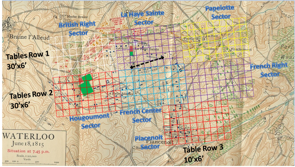

So everyone and their brother apparently on TMP has played Waterloo and is bored of it….to those who I am about to bore again – apologies in advance.
I am working through the OOBs of 1815 for the ultimate wargame – Waterloo of course. Currently planning on using Black Powder and have all units at the battle represented at the BN level. So yes a bit of an undertaking but 2+ years left until the anniversary and I like challenges.
I have played Waterloo a couple of times in the past but they were abstracted and at the DIV level – moving BDEs around like Napoleon's Battles.
After scouring the net I have only found the Wargames Centre in England showcasing a 28mm BN scale layout of Waterloo for a game. Even the setup they use compresses alot of the features of the battlefield for space trade off reasons. They use three sets of long tables to represent the battlefield.
I wanted to see what it will take to do a similar approach and my first stab at the setup is below:
This shows the whole battlefield using three rows of tables. Each table is 6 feet wide and 30 feet long – with the exception of the Placenoit sector I figured I could get away with a 10 long table. Between all of these rows of tables there will have to be a ~3' gap at a minimum to allow movement.
Aside from the fact that this game will be big, take alot of planning, gamers / umpires, effort, $ etc, I am looking to those who have run large efforts like this for their observations or lessons learned.

Nasty Canasta13 Nov 2012 2:13 p.m. PST
Wow!
Pretty detailed. Does one inch equal one inch?

mpanko13 Nov 2012 2:59 p.m. PST
Each square = 1 foot on the table. This will allow a decent translation of the BP rules for the game. There of course will need to have some scenario rules for dealing with the mud for the artillery – I was reading how ineffective the Grand Battery was in part due to the cannon balls burying themselves in the mud!

Timmo uk13 Nov 2012 3:37 p.m. PST
I'd be tempted to put a second table in the third row just so you can lay out the Imperial guard figures. That is unless you are using some sort of hidden deployment system, are you?

wrgmr113 Nov 2012 7:31 p.m. PST
My thoughts would be to use one 30' x 6' table for the main battlefield, and two reserve tables, one behind each side for holding and movement of reserves. One 10' by 5' or 6' for Placenoit. Similar to what our groupd is doing for Borodino in just over a week, using Shako 2 rules battalion level.
The difficulty as mpanko says, is having scenario rules which keep the French from literally running over the allies. They have 3 times as many heavy cavalry. Used in conjuction with infantry, they will be unstoppable. Possibley a timed release of units for the French?

mpanko15 Nov 2012 9:09 a.m. PST
musketier – to answer your question on number of players and the amount of figures…alot of each: 4 folks to umpire / run the game at a minimum; estimate the following for the teams:
7 French players at a minimum….each roughly handling about 12-15 BNs initially at a time
5-6 Anglo – Allied players at a minimum…same concept as the French above.
Prussians….think the approach march / entry would be an umpire event and then giving them to the Allies to run.
Unit count rough estimate – going strictly out of Adkins book…
French:
103 BNs @ ~24 each = 2472 foot;
34 cavalry regiments @ ~12 each = 288 cavalry;
34 batteries @ 2 guns each = 68 guns + 272 gunners. Probably more here as the French batteries typically were @ 8 guns each.

mpanko15 Nov 2012 1:02 p.m. PST
Those games would have been great to see! You don't have any eye candy photos to share do you?
I think the idea of a later start with the Grand Battery already in position adresses alot of time issues up front. It would definitely see the Prussians arriving on the flank in short order….again with the premise of using historical guide rails to keep the game 'waterloo-ish'.

mpanko16 Nov 2012 9:41 a.m. PST
I have to say I am leaning heavily towards a historic setup to start with and even kicking the game off at the start of the Grand Battery firing followed by D'Erlon's attack.
How D'Erlon arrays his attack and the support given to it will be the players decision – as well as the Allied response to it.
Additionally the movement of Lobau towards the Prussians began at about the same time that D'Erlon's assualt took place. So really right from the start of the game Napoleon already has a huge problem to deal with…how does he deal with the Prussians and press home his attack against the Allied line (simultaneously in progress).
That to me sets the start of the game – from that point foward I think the players shape the outcome. Some thought will need to go into the constraints on the Guard and Reserve Cavalry, or as pointed out above – you will see a completely ahistoric assualt of the guard, I Corps and the bulk of the Cavalry on turn I against the La Haye Saint and Papelotte area.
To be honest with you I don't really care what the outcome is…I think the experience, the scale, and the occaision itself is a pretty big treat in itself. This game has always been on my "gamer's bucket list" and since I won't be around to see the 300th anniversary I might as well go for it now!
