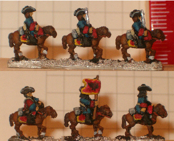

Your suggestion may work for line infantry but you will need a very smooth surface and some of the figures are top heavy as well.
I will not work for skirmishers, missile troops or cavalry as they are cast on a base head to tail . Artillery also will be i a straight line of four so your guns will ave a single line of gunners behind.
If you really want to go baseless then Irregulars may be an option as hey come in blocks

A problem with Baccus 6mm miniatures is that they are lovely detailed, but fragile. Especially the horses. If you really would like to use unbased strips, I advice you to choose the Irregular ranges -less spectacular but also less fragile, and the cavalry and artillery figures are already based.
