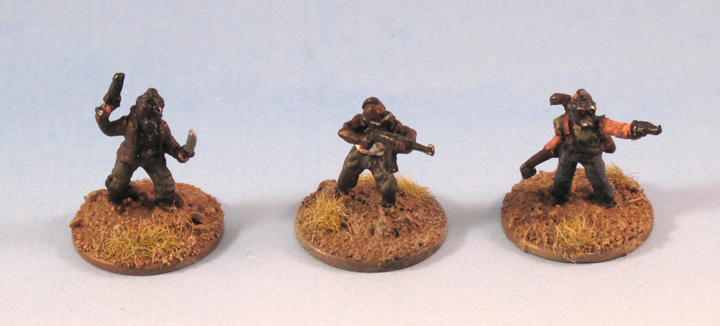

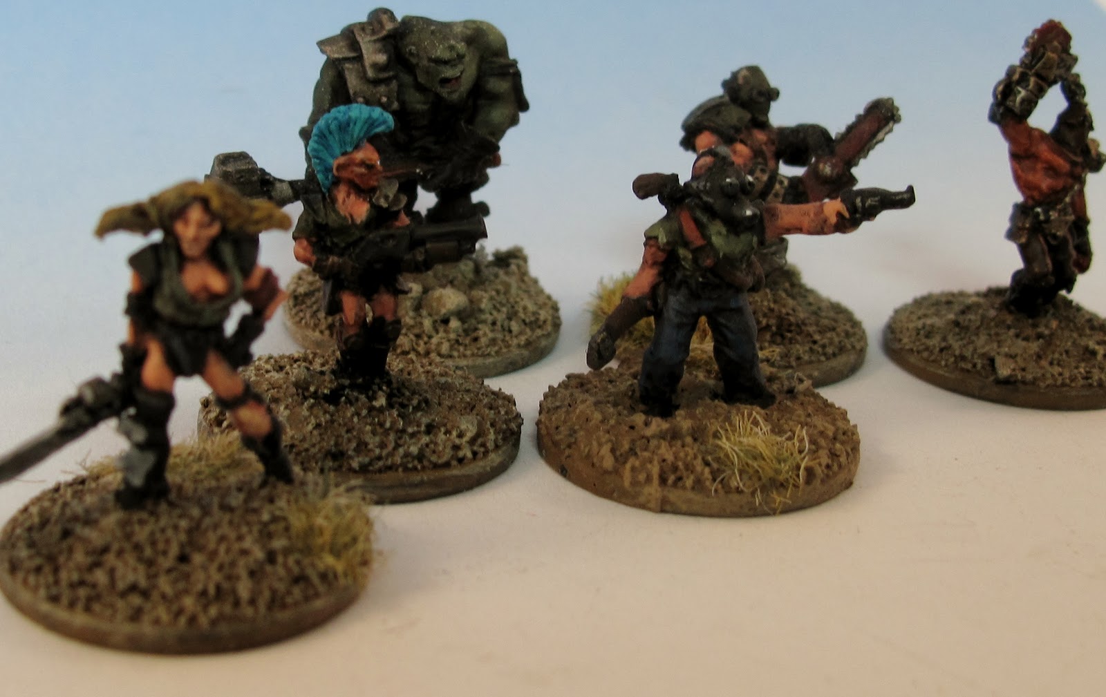

Here are some headswaps with Rebel and GZG figures and GZG heads:
