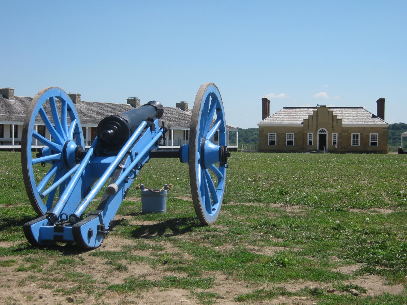

I happened to be on this site:
I noted the US artillery as given as olive green with black fittings.
Now this is correct for the Civil War but the guns at Historic Ft Snelling representing the US army in 1827 has the guns painted in light blue with black fittings.
historicfortsnelling.org
Which is correct?

U.S. guns were light blue for the War of 1812. In Military Uniforms in America Years of Growth 1796-1851 by the Company of Military Historians pg 87 shows the guns of 1825-1832 still painted in light blue.

138SquadronRAF30 May 2012 9:26 a.m. PST
This is the gun from Historic Ft Snelling that prompted the question – shows iron axle.
Here's the gun Rudy quotes:
Looks like a wooden outer covering, done know if there is an internal iron axle as on the civil war guns.
Can I assume that the colour of the gun carraige is correct for 1812?
If the gun carriage is correct at light blue, are there other colour errors on this site?

From the photos we have so far
1. One Gribeauval 4-pdr carriage with an iron 6-pdr
2. Two British Muller style carriages with iron 6-pdrs
It is still unclear as to what carriages were used by the US Army in the War of 1812.It would be nice to know.
This shade of blue reminds me of Spanish Ordnance [Naples Blue] rather than the mixture of Prussian Blue and White Lead.
