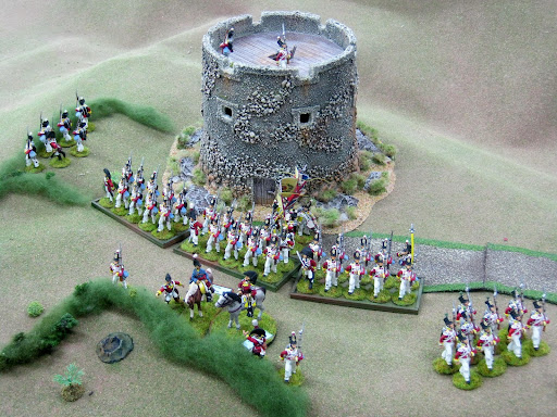

chuck05 Fezian16 May 2012 11:06 a.m. PST
@wrgmr1: Sure. These are the only pics I have at the moment. I'll see if I can find some more. Im working on some desert themed roads at the moment too.
Those are 20mm tanks in the pics for a scale reference.
Chuck
chuck05 Fezian16 May 2012 11:31 a.m. PST
Here is another shot of the roads with some 28mm seven years war figures

Not bad, Chuck. Not bad at all. Thanks for sharing! Cheers!
darthfozzywig16 May 2012 3:25 p.m. PST
Very cool, Chuck!

Thanks very much for the photos Chuck! Nice looking roads, I'll have to try that.
