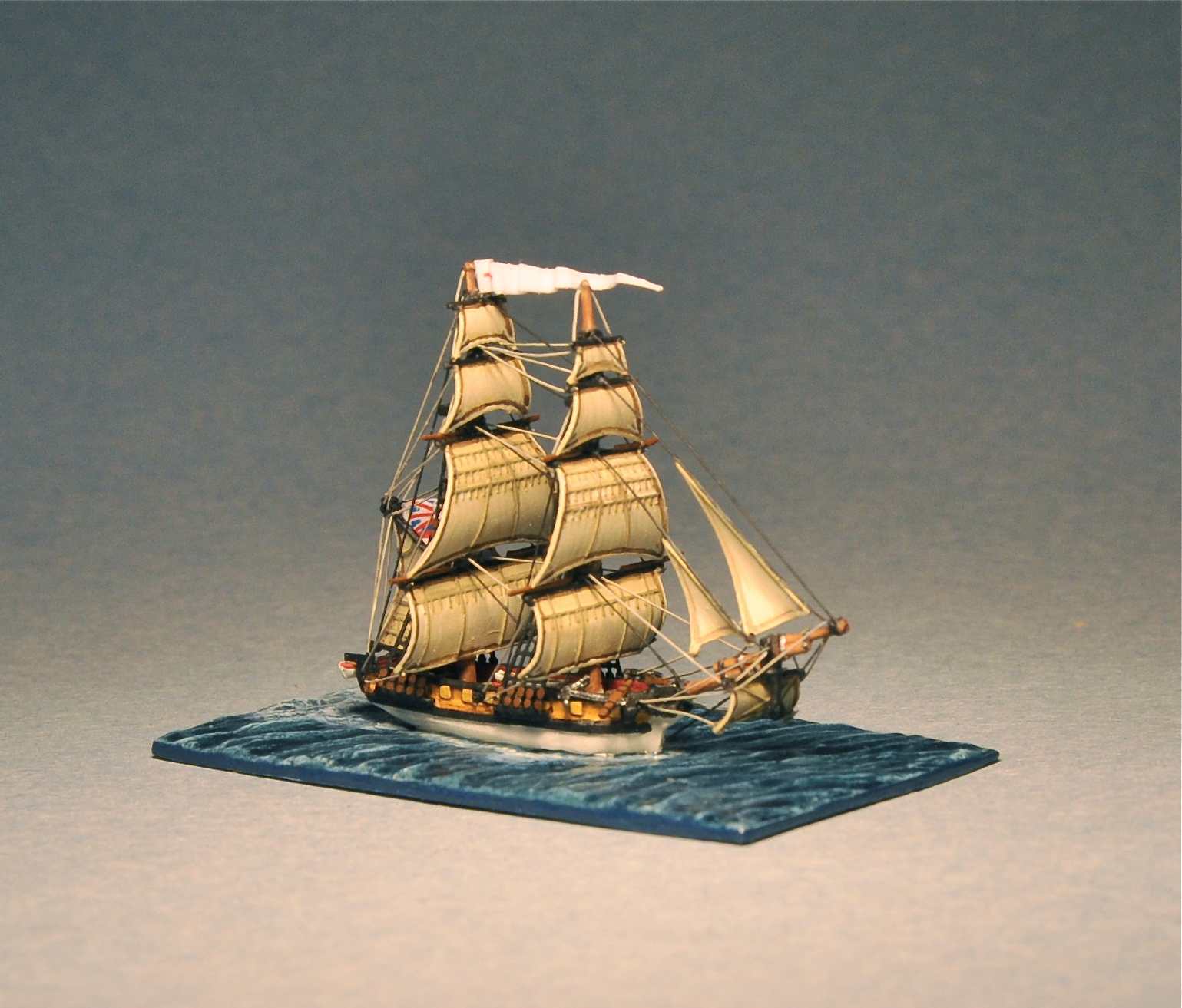

Hello folks. I've been working on some Langton 1/1200 Napoleonic naval pieces recently, and just wanted to share photos. The latest one I've finished is a 20 gun brig. You can see more photos on my blog at

Wow – those are really nicely done! I put together and painted on Langton ship, and promised myself Id never do it again (the rigging ugh!)….so, I KNOW how much work you put into this!

WOW! How many hours to paint one of these guys?
Big Red10 May 2012 12:59 p.m. PST
Magnificent! Those bases compliment your ships like a great frame for a nautical painting.

Thanks guys, I appreciate it. As for how long they take to paint, it's actually hard for me to say. I've never timed it carefully. It's definitely the rigging that takes the longest amount of time though. I'd say they usually take me about a week and a half, just working on them a bit in the evenings. Helps me stay patient with those tiny threads if I don't try to get it all done at once!

The rigging is all 'invisible' thread, a synthetic mono-filament that is sold for quilters who don't want certain stitches to show up. It's strong and thin and relatively easy to work with. Then I paint it with thinned down paint of the appropriate color, black for standing rigging and a sort of concrete for the running rigging. I like this approach because it gives me the option of not painting where the thread is tied around certain points, so the knots are then hard to see.

I am currently working on a few ships from Langton. Your work is really nice ! What about this anchor I can see on the brig ? Did you make it yourself ? I bought 20 or 30 ships from Langton but never saw any…

He got them from GHQ kits – most of theirs have more than enough anchors for the kit being built (i.e. SPARES!),

BTW, why do you prefer the brass sails over the 3D-effect cast sails? True the brass ones are thinner, but they look too regular in shape from the side, IMHO.

Hinds – personally I like the brass sails just because they are so thin, it feels more to scale to me. Although I have a couple GHQ kits with masts and sails that are all one piece, all cast metal, and I was surprised to find them as satisfactory as I did.

Really beautiful job! I especially like the rigging and water. What did you use for the base?

Volunteer – the bases are ready made resin pieces from Langton. I like to use larger ones than they recommend for particular classes of ships, both for the appearance and for the safety of the model. Has to be at lest long enough to extend beyond the bowsprit, and leave a margin behind.
