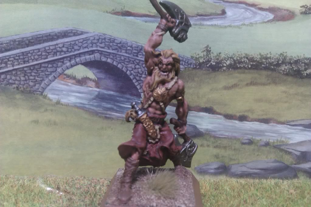

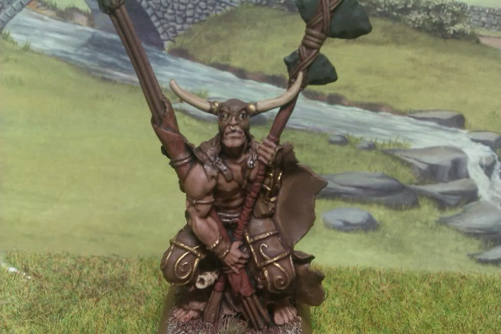

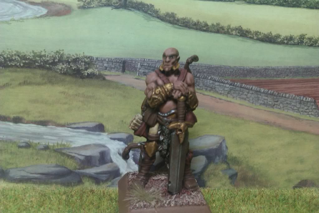

I've decided that I have way too much lead to be painted conventionally, thus I've decided to speed paint my collection.
Tamiya TS-1 Red Leather spray undercoat/basecoat or Army Painter leather spray primer on occasion.
Then 1 coat, with highlights sometimes on hair or the odd dry brush here and there.
Army Painter Strong Tone dip, painted on with a soft brush. Bit of turps used to wick up the pools.
Dullcote matt varnish, then application of coarse pumice mixed with sand and brown craft paint and dry brushed with cream craft paint (have switched to Citadel dry paste "Tyrant Skull" for a laugh. Not bad.)
Silfor tuft stuck on. No glue required for this it seems.
