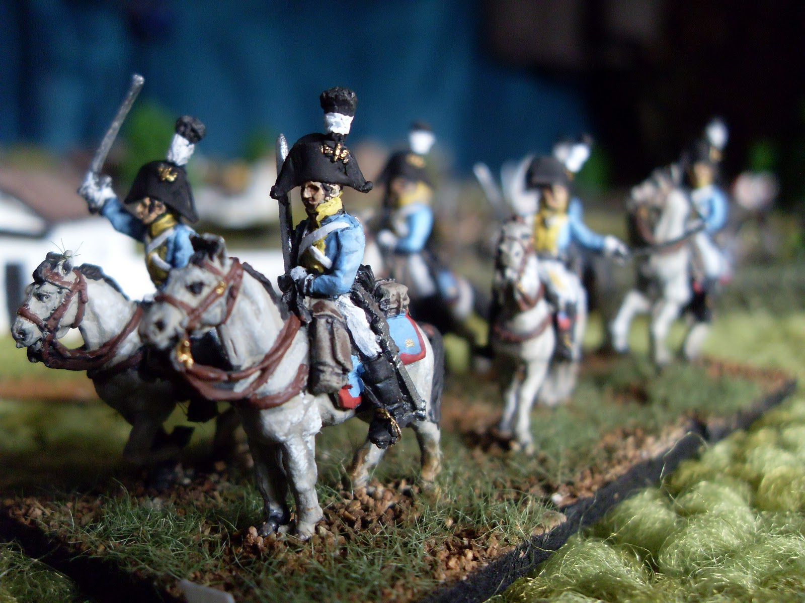

Here are some 15s I cooked up earlier :
You see what I mean here by the dappling – looks the part on grey horses, and is super simple to do.
Note that the brown horse has a bit of variation and shading – this is just the glaze coat doing its magic thing. The vallejo glazes are soooo good, that it feels like 'cheating' sometimes, but the results are always worth the guilt.
Here are some 18s I cooked up earlier as well :
Again, single shade of base coat in all cases, with variation in the level of glazing and amount of highlighting … looks almost like totally different mixes of colour in some cases.
Here are some more 18s I did before the Saxons, using a tinted highlight on the grey. As you can see from the shot, its really not too different to using straight grey :
So its just straight grey when highlighting grey horses for me from now on.
