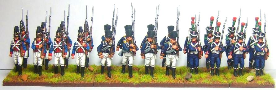

I have reviewed all their Napoleonic sets on my blog. You can read through the links below, which do include some comparison shots with other manufacturers.

scomac, will check your blog tomorrow (bedtime now, sleepy…) but the pic you've posted here looks good.

PacificC02 Feb 2024 7:18 p.m. PST
Here are some 28mm Hungarian Infantry for testing purposes:
