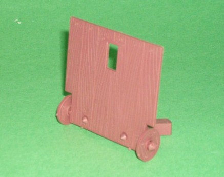

But why didn't troops in, say, WWII come out of landing craft and other vehicles with some sort of "mantlet" or shield that would afford some protection until they established themselves on the ground?
Perhaps something like this, but reinforced against firearms like the front of a landing craft:
Three or four put together would have created an instant, albeit temporary, bunker until they dug in and sand-bagged properly, right?

But couldn't some sort of shield have been rolled or pushed a short distance (even if just a few feet) after coming out of the landing craft?
It would be temporary, of course, and not meant to be a vehicle itself.

Perhaps something like this but with wheels:
Even with wheels added, I wonder how heavy something like that would be.
Dan
