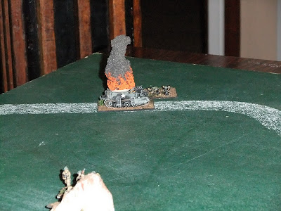

I use rough grey computer packing foam hacked into plume shapes with the base painted in dayglo orange.
Here is one perched on top of an unfortunate carrier:
Hamster bedding is very fibrious unless you can fix it with something (spray varnish? hairspray?). I still use the bilious green bedding as phosgene though.
