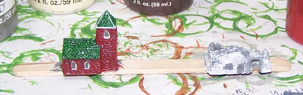

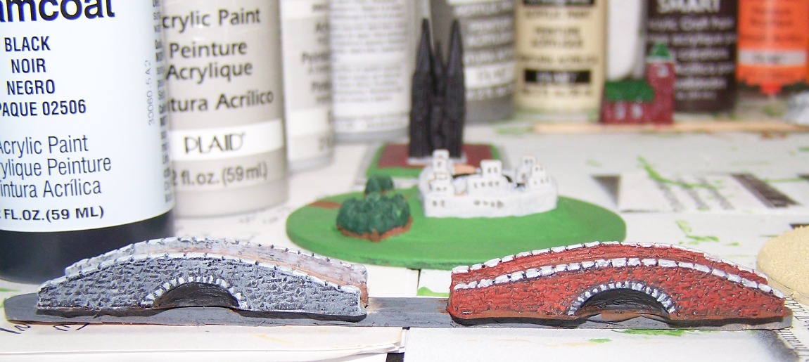

boy wundyr x15 Nov 2011 9:24 a.m. PST
Agree on the contrasts, including between door/window frames and the walls. If doing ruins, simple works, but colour is nice (I painted a crooked landscape painting* on the interior wall of one ruin).
* = brown outline (frame) with green spots!
Some of my own:
(shininess due to a coat of Future prior to Dullcoting)
