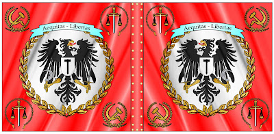

abdul666lw04 Nov 2011 5:43 a.m. PST
I concur with Enteburger: for a small fee David will kindly help you 'finalizing' your design (he's awesomely knowledgeable, full of ideas, and extremely friendly), then draw a beautiful definitive version.
Many of his works appear on the NPU forum (Pangaea), unfortunately 'down' at the time being. Other exemples on the Direkrorat of Herrschaden ( link and older posts).
Exemples of what he did for Monte-Cristo:
(of course you can deeply dislike this design -mine- but agree that the final rendition is beautifully done!).

I start in MS Paint with a huge catalog of heraldry and templates for most of the known "national" patterns, then I export to The Print Shop to get it sized exactly the way I want it, then export from there to a pdf file at 600 dpi and usually about twice the finished size. When you print the pdf file you scale it to 50% and it holds the detail and blacklining much better. The finished flags will be both sides plus the "sleeve". You can glue them together with a glue stick or diluted white glue (PVA or Elmer's), slip your staff in place and then use paint brush tapered handles to lightly curl the flag and add ripples and character to it. Once the glue dries and you varnish, it's all permanent.
