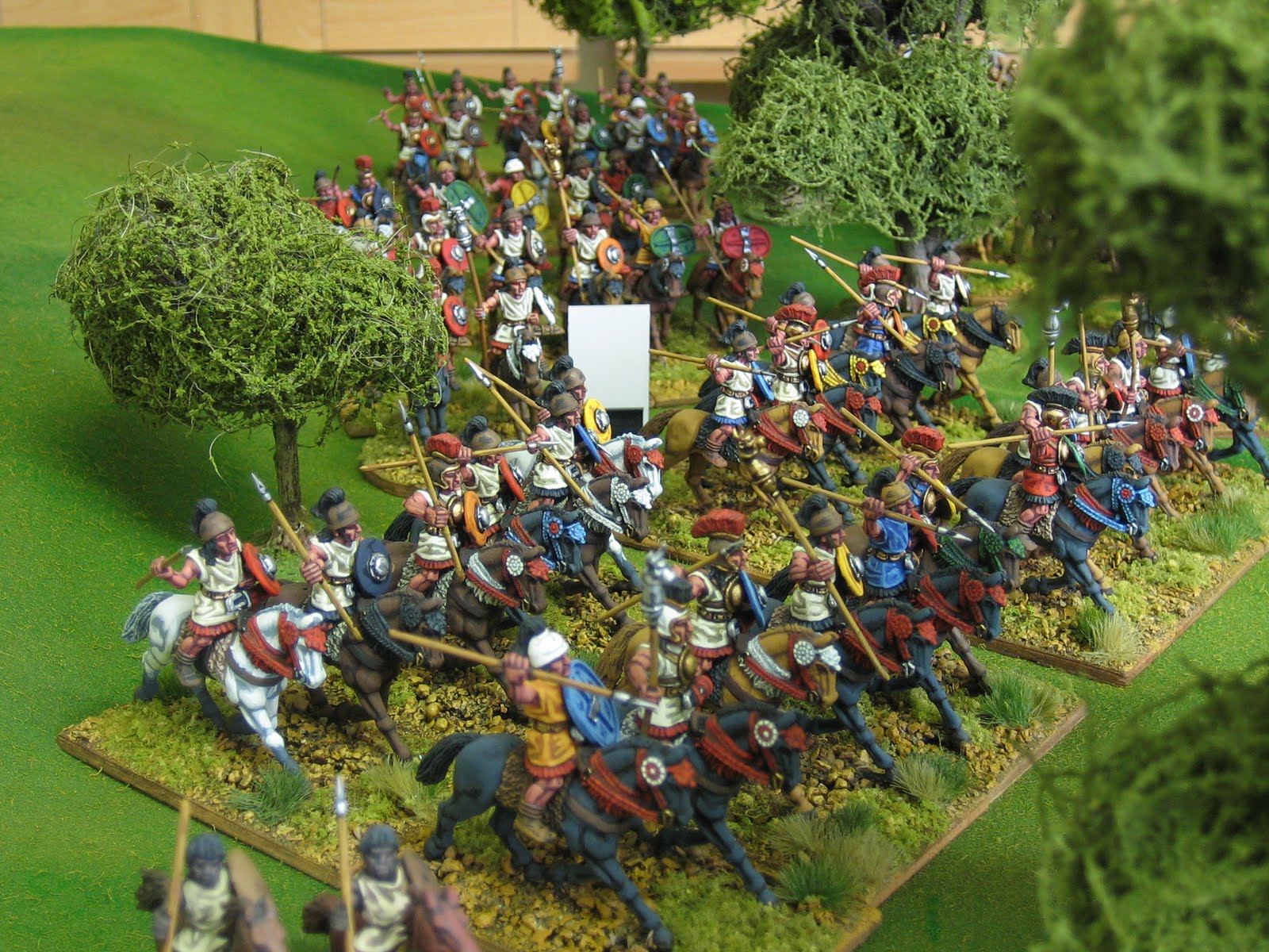

olicana10 Aug 2011 10:40 a.m. PST
olicana10 Aug 2011 10:44 a.m. PST
Lots more horses here
All Humbrols, fantastic paint!
