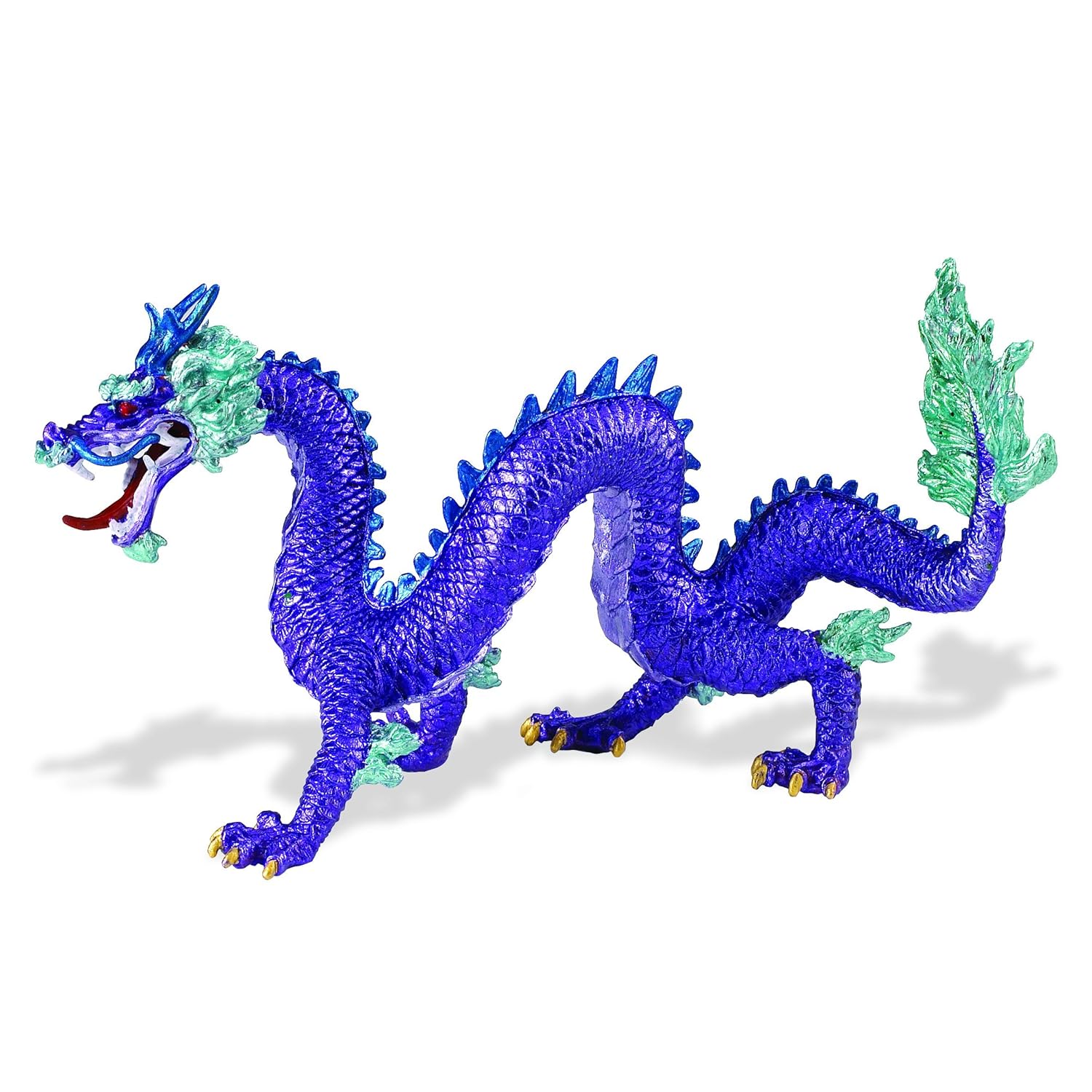

I'm thinking about stripping the paint off one of these Safari toy dragons before painting it as The Metallic Dragon. IIRC a very early "The Dragon" magazine described Bahamut as an Asian dragon and I'd like to give that a try.
img64.imageshack.us/img64/4338/51e86mlmnrl.jpg
Any TMP'ers have experience with this? I've got "goop off", Brake fluid, acetone and simple green currently, but I wanted to get the wisdom of TMP before experimenting.

Could, but a lot of toys get very thick paint jobs at the factory, obscuring a lot of potential detail. The claws & teeth of this fig look like they had a lot of detail before the paint was glopped on, so it might be worth the trouble to strip this one.
Edit: There is another colour of the fig available, when i saw it in store it was a a much lighter purple than it's online pics show, but the details look a little crisper, so I'm confident the detail is there.
ecx.images-amazon.com/images/I/91SE7mp9ZSL._AA1500_.jpg
ep.yimg.com/ca/I/yhst-15283712207476_2150_30557403
And the manufacturer paints are often as tough as the toy they are painted onto, making stripping them without melting the fig tricky.

The problem with some of those plastic figs is that the color is part of the molding process. It might not be too easy to remove.
Ive had good luck with Simple Green. Ive had it remove enamel and acrylic paints along with primer. I havent had it affect any plastics in a negative way. Maybe try it out on a cheap item to see if does any good.

If my experiments slag the figure, it's not that big of a deal. Buying more than a few new strippers would cost me more than a new Safari Blue Chinese Dragon from Micheals ($7 w/coupon). I was just hoping to see if anyone knew what stuff worked.
I'll try simple green since you suggested it, Chuck. I didn't think it would be potent enough TBH.
chuck05 Fezian30 Mar 2011 3:13 p.m. PST
I use Simple Green undiluted. I get the gallon jug and just use it straight out of the jug.

When you paint make sure you wash it to get rid of any residues, plastic toys can be a swine for that. To help paint stick give it a light rubbing with fine emery paper and, depending how flexible the plastic is, a diluted pva undercoat will help.
frankthedm30 Mar 2011 11:03 p.m. PST
Dozing Dragon, washing isn't always enough, the plastic can absorb the stronger chems or be changed by the chems. Even a quick acetone scrub on a Mage knight fundamentally changes the plastic, leaching out some of the plasticity after it 'dries' DAYS later. Some spray primers do similar things to Wotc plastics, causing them to feel tacky.
EDIT: 7 hours after dropping some samples in simple green, no effect.
frankthedm03 Apr 2011 10:31 p.m. PST
Simple green had no effect on the figure or the paint after 3 days. Might try "goof-off" next
