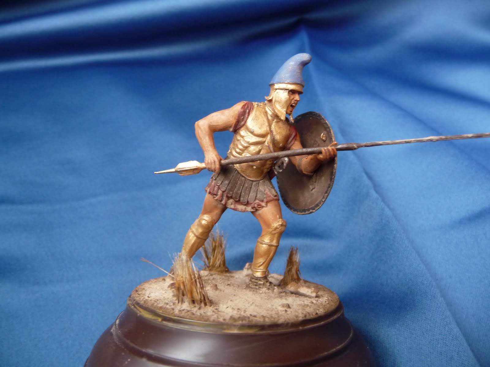

This 54mm fgiure seems to have it right… the model has his hands spaced apart enough to be able to thrust and stay balanced (although the modeler has not added the shoulder strap here either):
One can see how the shield has the forearm grip, and how the sheild lays on the shoulder and back. The strap drawn tight around the pike would help the grip, and the hand is outside the shield rim.
this figure seems to have a combination Boeotian Thracian helm from an Igor Dzis painting, it certainly is interesting, and I have no idea if it was common for infantry.
