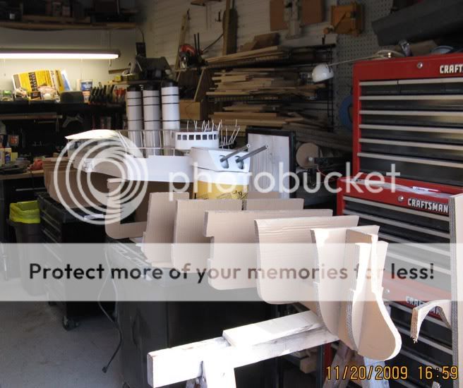

Dad built this ship out of duct tape and cardboard (and a trash bag to be used in "firing" the guns.) These are pics from it's first float test.
I've been posting these pics everywhere I can, 'cause I'm pretty darned proud of Dad.
The scale is 1/24 and the ship is of the USS Missouri BB11 built in 1898. The ship is built as a stand off model as it appeared when it returned from sailing with the Great White Fleet.

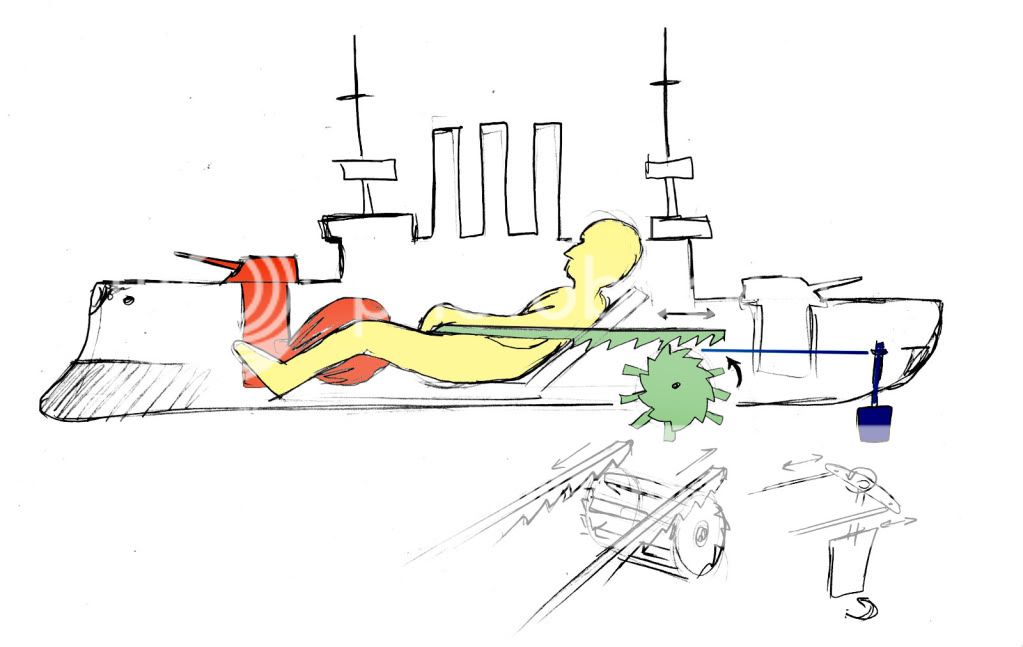

Absolutely amazing! I'd love to read an article about the techniques he used to build it.
Could you please elaborate on the comment you made about a trash bag being used for firing the guns? How are the guns fired, etc.?

Lewis: The trash bag serves as a simple airbag (within the barbette) connected to the gun barrels (filled with a bit of talcum or flour.) The ship is run by a pilot reclined inside the hull, who can squeeze the bag to simulate the firing.
Propulsion is by a rack and gear (still out of cardboard) system that's a little difficult to explain in words, but was a novel solution. If I can find time, I'll draw a diagram and post it to my blog (and link it on this thread.)

I don't have much info on exactly how he went about it. But I do have a few more pics on my blog from when he was working on it.
For the past year and a half he's added a little bit here and there until it was done. The hull is ribbed with triple-ply cardboard (stuff they use to line the bottom of cargo palettes.) He worked from ship plans of the U.S.S. Ohio(?) which is the same class.

"The trash bag serves as a simple airbag (within the barbette) connected to the gun barrels (filled with a bit of talcum or flour.) The ship is run by a pilot reclined inside the hull, who can squeeze the bag to simulate the firing"
Do I understand you to mean that a person lies down inside this thing and controls the propulsion and guns while it is floating!

evilcartoonist07 Jun 2010 11:27 a.m. PST
"Do I understand you to mean that a person lies down inside this thing and controls the propulsion and guns while it is floating!"
Yep! I drew up a quick sketch of the internal workings here: picture
Yellow is the pilot's position; orange is the weapon system; green is propulsion; and blue is navigation. This is as best as I can remember it.
Also- here is another photo showing a better shot of the internal hull construction: picture
