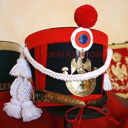

Here's a photo of French shako pompoms sold by a dealer. It shows the pompom with a looped wire:
A set of close-up photos of a French shako. Maybe assume the looped wire inserts into the middle section of the metal plate?
Dutch50802 Jun 2010 10:53 a.m. PST
The shako in the last isn't a french patterned 1815 model.
This shako from the 57th Line shows how the pom pom slides behind the cockade.
You can see in the second that the cockade is attached ith two wires on the side. This shako is a line grenadier headgear, with cords attached. Again the pom pom slides behind the cockade.
