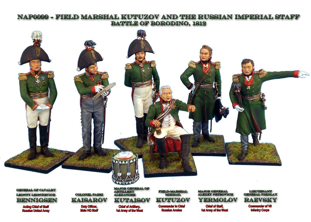

Here is some miniatures already painted of the Russian staff with Kutuzov in the middle cap on the drum.

A reason that we may be having some trouble is that these miniatures were designed after early lithographs by Орловский Александр Осипович / Aleksandr Osipovich Orlovskiy (1777-1832). As lithogrpahs, they were in black/brown and white, you see. I link them below, and some "canonical" colorized versions of the same uniforms.
Kutuzov
That hat is a trooper's foarge cap from a the Life-Guard Horse regiment / Лейб-гвардии Конный полк.
Platov
Bagration
The image from the catalog is a little hard to see. Do you have a better photo of the miniature ?
The miniature appears to be wearing the (gray) cavalry overalls – to me rather doubtful. As for a hat, are you sure that is not his great head of hair? Bagration is canonically depicted in regulation dress uniform, but quite often without a hat.
