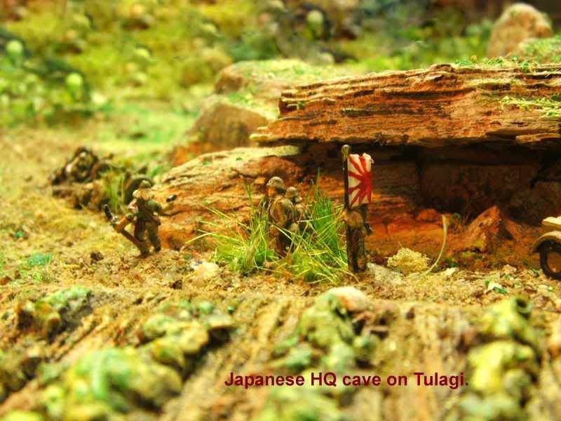

Mal Wright Fezian20 Jan 2010 11:38 p.m. PST
Although not of much use for the crumbly rubble, a good way to represent rock formations is with layers of thick pine bark. It varies with different types of pine, but some can be up to 30mm thick. The edges give excellent impression of rock formation and are easy to paint for various regions.
BTW…the photographs show the same rock formation in use during an Ancients battle and a WW2 game.
