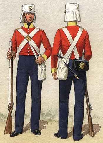

British Infantry, Afghanistan, 1842:
British Infantryman in India, 1840s:

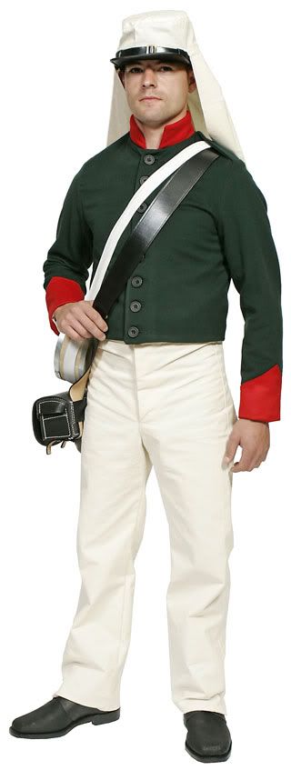

Rifleman, India, 1850s:

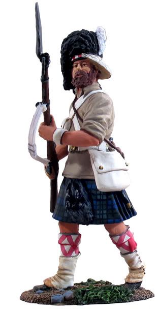

Highlander, India, 1850s:
