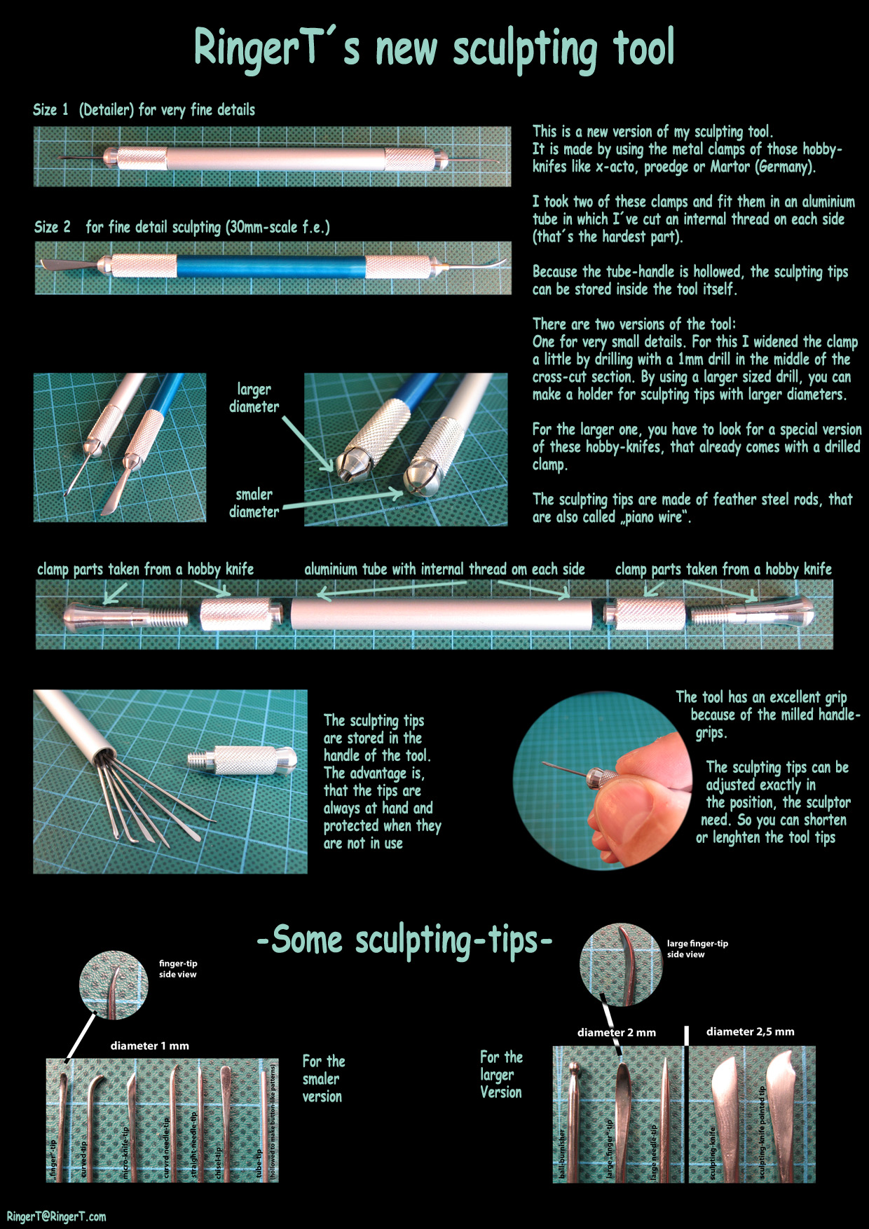

Now I made a new sculpting tool in two versions.
In my eyes the new one is better than my "old" pencil-tool.
Here you can find pictures an a description.
Please tell me, what you think about it

Have you noticed any problems with the tool head slipping?
Just curious? Interesting enough concept that i might have to give it a try.

I would send you a couple of this tools, if I would produce them in large amounts, but I only made 4 for me and some friends. So if you know a company who is interested in producing such a tool, please let me know:-)

With the older Pencil-tool there was a problem with the tool head slipping in the beginning. Especialy the curved tool-tips sometimes rotate during presseng them down because the grip (clamp) of the pencil wasnīt strong enough.
But this could be avoided by 1. take a pencil with a metal-clamp inside (not a plastic one) and 2. flatten the tooltips where they sit in the pencil-clamp, so they arenīt "round" anymore. By doing this, they sit much stronger into the pencil.
With the new tool, this isnīt an issue, because you can control, how strong the tips fit into the handle, just like you can with the blades, that are usually placed into that clamps.

How did you make the tips? Did you heat the wire, I thought Piano wire was hard and brittle,to soften it, then did you anneal them? Are you a machinistdid you turn the handle yourself?
RingerT12 Jun 2008 10:35 a.m. PST
No, Iīm not a machinist. In fact I havenīt got any technical background. Itīs quite easy to get the pianowire into shape by heating it up over a flame and using a hammer and an anvil or another hard surface. The most work is done by using a dremel-tool to gind and polish the pianowire. Dan Perez made a tutorial for that. You can find it here:

Unfortunately most of these pin vices (including the ones on your picture) are not ideal for using them as a holder for the sculpting tips. The reason is that they are too thick (the diameter is too large). Thatīs because of the method they use to hold the drills (or other things). Most of them have a clamp, that closes, when it is pressed down by screwing a nut-like part on the top down. Because you need that nut-like part over the clamp, it makes the whole thing quite thick.
The clamp-system I use, is from those hobby-knifes and it works in a different way. Here the clamp isnīt pressed down by a nut, but the clamp itself has a thread and "pulls" itself into the handle while screwing it. Because here you didnīt need a nut, those system makes the whole thing thinner.
The good thing is, that a few weeks ago, I found a double ended pin vice, that uses the same clamp system like those hobby knifes. The downside is, that it is a little heavy (about 31 g) and still a little thick (about 8,9 mm diameter instead of the 8 mm I would prefer). But with this it could work.
If anyone here knows a double ended pin vice with a round handle (not hexagonal) and with a diameter of about 8 mm, please tell me.
