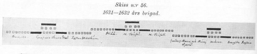

Compare this print of a Swedish brigade
With the detailed drawing made to scale for military use
While the TE print certainly gets the shape right it gives an erronous impression of the depth and frontage of the brigade and leaves out key parts of the brigade formation such as the gaps between the musketeer corporalships and the fact that the musketeers of the centre squadron are not formed up as single mass of men with little space to spare
And "perceptual reality" or not the Lutzen prints provide an erronous description of the Imperial deployment and formations. If used as a valid & accurate source the end result will be misleading.

OK, let talk about your pictures. You use one picture to expand upon the limitations of the another. I find that ironic. Especially since you argument is: "I didn't say that one should discount images, only that they are a hard sources to use and need to be carefully verified by OTHER MEANS."
Nevertheless, if one wants to understand how the three battalions of pikes with their shot were formed by the Swedes, the first picture is quite adequate by itself. We don't need the second picture. And, we don't need it to be verified by any other means. The first picture doesn't tell us how these battalions worked together. Did the rear units move forward to come on line with the center battalion or did the center battalion fallback or did they remain in this position while being attacked? The second picture doesn't tell us either.
I have copies of these pictures as well. With regards to the second picture, we must take care. This was an example of an older, out of date, diagram of how the Swedish brigade was formed. Please notice the fourth battalion of pikes at the bottom of the page. If you were to try use this picture to show how the Swedish brigade was formed during the TYW, then you would be quite wrong. It would be just as misleading as trying to show that an older formation was used at Leutzen.

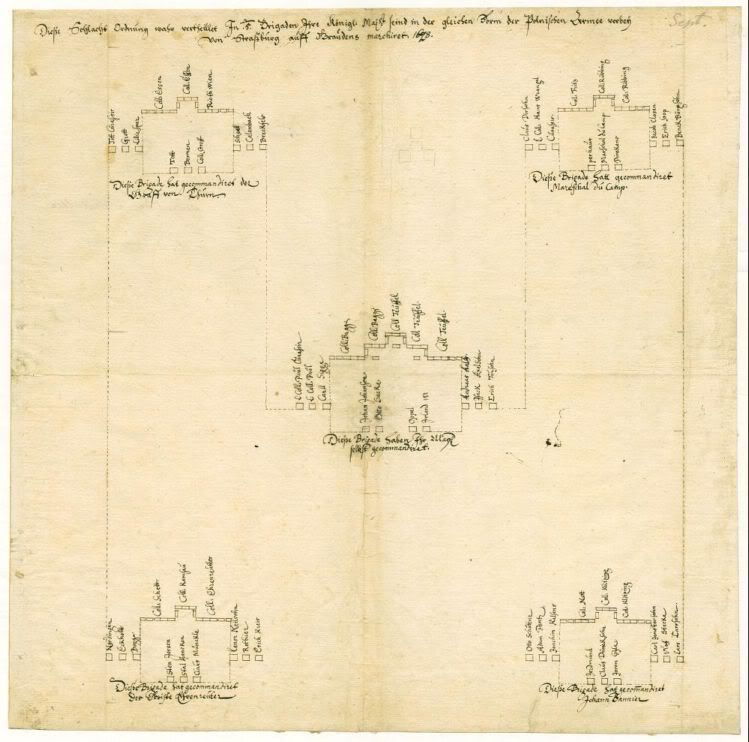

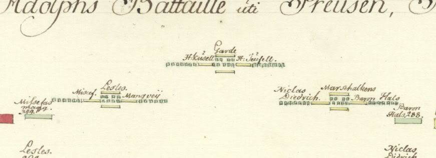

What you have is the scan posted to the now gone Rempas Yahoo group from where it was copied to Renwars. It was originaly posted to the TYW yahoo group in 2002.
However I work with the original document. I used the scan in question since it was available and easy to link to.
You seem to have missed the next part of my statement were I separate images into two groups. Those made for public usage in work such as Theatrum Eurpaeum and those made for actual military use such as the diagrams publlished in Wallhausen's works or the documents used by the various armies for their actual operations. Two diffrent kinds of sourcematerial even if they both can be described as images. All images are not created equal:-)
Your are right that the diagrams& images I've posted doesn't tell us how the brigade worked in action. That is why one has to use other sources, both written & pictorial, to complete the picture.
So we don't need the 2nd diagram do we?! ;-)
After all the detailed informtion it provides about the frontage and depth of the formation (notice the little scale at the bottom of the scan), it's depciton of the spacing of the shot and the fact that it shows us were the brigade artillery was posted is of no use at all to the military historian. ;-))
An old, out of date diagram? The 4-squadron brigade not used during the TYW? Care to provide sources to back up those statements?
The historians employed by the General Staff, Bertil C:son Barkman and Richard Brzezinski all disagree with you. As does Gustavus himself since the 4 squadron brigade appears in at several of the diagrams of the deployement used by the Swedish army drawn by his own hand, all dated to the TYW period. Lord Reay (Col. Mackay)recorded it for posterity as well.
The apperance of the "Swedish brigade" is directly linkedto the Swedish entry into the TYW on large scale in 1630. (Sweden had been involved in the war on small scale from 1628) Indeed there is no evidence for it's use prior to 1630.
The document previously dated to 1628 which was used as evidence for the use of 4-squadron brigades can now be proven to belong firmly to 1630 due to the presence of units which either did not exist in 1628 or were not deployed to Prussia. Said units did however form a part of the Swedish army in 1630. Furthermore the the presence of two units which in late 1630 were reformed into a new regiment narrows the gap even further and firmly places the document in 1630.
While brigades are mentioned during the Prussian war of 1626-1629 a study of the surviving order of battles show that these brigades were much larger formations made up of both horse and foot.
Nor do the deployments show the 'Swedish brigade' with typical shape. Instead you find infantry squadrons arranged in much larger, triangular formations inspired by Dutch tactics. (But adapted to the conditions of Swedish-Polish warfare)
The 3-squadron brigade was merely a 4-squadron brigade without the 4th (reserve) squadron. It's presence or absence did not alter the formation of the 3 frontline squadrons. As is shown by the brigades deployed at Frankfurth in may 1631
Do note the absence of the commanded shot which had been detached to act independently.
The reserver units (4th squadron, commanded shot) of the brigade were used as needed. In at least one instance Gustavus detached not only the commanded shot from the brigade but also the shot belonging to the 4th squadron leaving a pike-only reserve.
So the diagram is neither old, nor out of date and the fact that it is drawn to scale and contains a wealth of additonal information makes it one of the most important sources for the study of the 3-squadron or 4-squadron brigade during the TYW.
