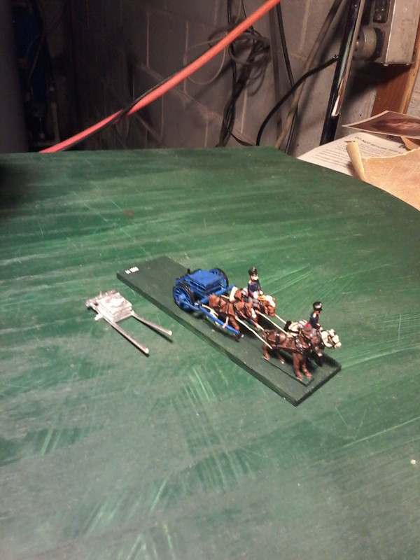

Finally getting to British limbers and while usually can tell what things are, wood or metal but the sculpting on edges of the ammo boxes look like materiel as dropped eve has ripples all around. Painting Blue Moon limbers not that where they come from matters much.

14Bore Supporting Member of TMP09 Jan 2021 1:45 p.m. PST
First attempt,thanking Dr Summerfield on how the harness went
