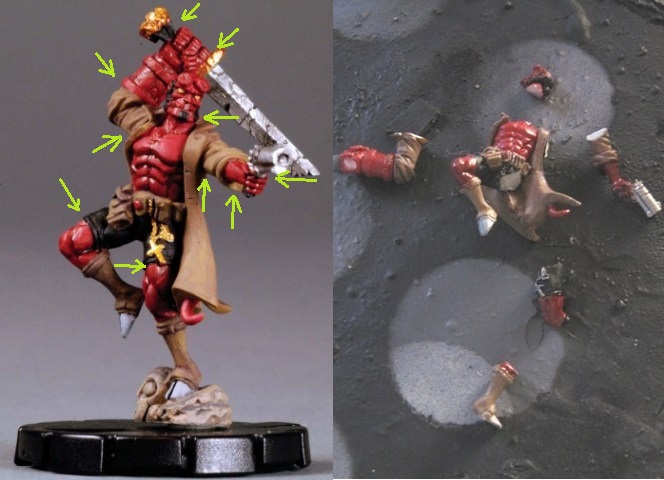

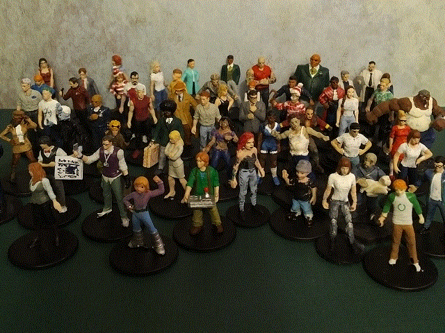

Personal logo etotheipi Sponsoring Member of TMP08 Mar 2019 8:37 a.m. PST
I wouldn't go the bending route.
There are tons of different ones in different positions.
I tend to look for what I call an "open" pose, at least for the areas I want to change.
This shows one of the more open ones and how I used various reworking for this project.
Depending on where and how you cut, you may or may not need to smooth the joints.
For these projects, I usually sue a "both sides" approach – Here's generally what I want. There's what I got. How do I meet in the middle for something awesome?
