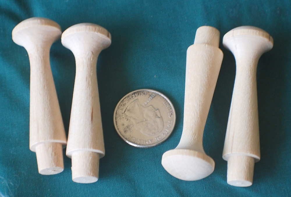

Cacique Caribe02 Apr 2013 2:16 p.m. PST
I would love to send out a handful of shaker pegs to carve out as Egyptian flower lotus columns with a lathe!
At the very least, ONE to serve as a master for casting in resin later. All I would need for them is for the lathe to flatten the top and then to cut the 3 or 4 neck grooves and the base groove.

ancientsgamer02 Apr 2013 2:36 p.m. PST
Dan, a lathe would need to puncture both ends to work properly. My dad and I share a shopsmith so we have a lathe but not the expertise to use it….

Joe Fish02 Apr 2013 6:46 p.m. PST
Shaker pegs as Egyptian columns! Clever idea!

RexMcL03 Apr 2013 10:14 a.m. PST
Dan-
30mm is pretty small for a real lathe. You might try putting a short piece of dowel in a dremel or drill etc.
Use sandpaper (wear a dust mask!) and various tools to shape it the way you want. With the low forces involved you shouldn't need a tool rest or anything.
