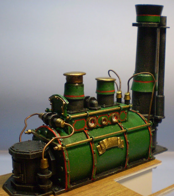

I don't know where to get complete engines, as I build my own bits from scratch:
But I'd be happy to discuss techniques and materials, if you have any questions.
Obviously, you'll be adding a lot of rivets, right…?
All the Best!
Pole Bitwy PL21 Aug 2012 3:41 a.m. PST
Colonel those engines are amazing ! Very, very nice and that is exactly what I am looking for ie. hand made.
Basically you start with some kind of barrel / container and add exhaust pipes ? Also, how do you make rivets ? I need to scale them to 1:72 and 1:100.
Thanks again,
Piotr
Colonel O Truth21 Aug 2012 4:06 a.m. PST
I usually start with a barrel and then 'strap' it – i.e. put meal bands around it. This adds bulk.
You MUST have a chimney, of course. Then just add boxes, cannisters and tubes until you are happy. The more the merrier. It doesn't have to make sense – this is FICTION, right?
For rivets, I use plastic rod, cut into pieces about 1/2mm thick with a sharp knife and glued in place with a pin or similar tool. It's not as fiddly as it sounds, once you get the hang of it.
The various bendy conduits are brass-wound guitar strings.
Anything else you need to know?
