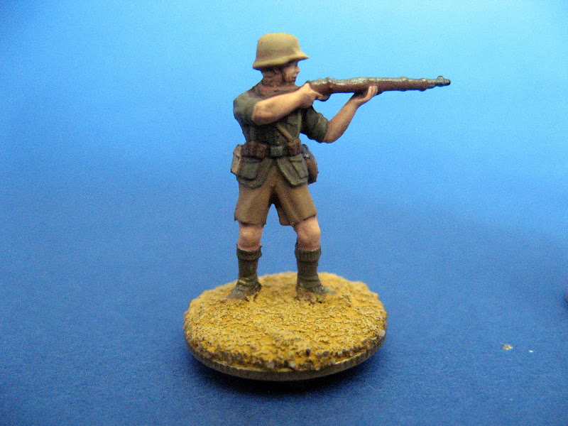

Take a look at these miniatures, DAK though, they were "washed" with abovementioned glaze: (I know, they are medicore at best)
– too thin I think

They look fine to me.

P.S. Your DAK guys look really good – shaded, yet all the fine details (like badges, etc.) can still be made out clearly.

Yeah, those DAK figures look nice! Are those 1/72 plastic?
Przemos8513 Mar 2012 11:51 p.m. PST
Yes, they are – Italeri – new tooling and ex-ESCI.
