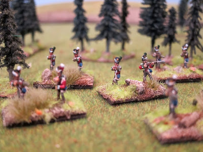

I brush on some walnut wood stain. It's water based so easier to clean up than the army painter stuff. Comes out really well on 10mm, especially if there is a bit of detail in the castings. Combine it with a coloured primer and the painting really speeds up.
Horses go well with a brown prime then dip. Pick out a few details and done.
White goes a bit muddy, but a quick highlight can fix it.
For more pics see Http://10mmnapoleonics.blogspot.com
